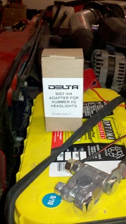

I also bought 9007 to H4 adapters incase i need it for the wiring and trying to cover all anticipated snags. Not sure if it?s needed, but i want to cover all bases. If these work, it is a hell of a buy even if you might need the adapter as the closest HIDs are 700 dollars more.

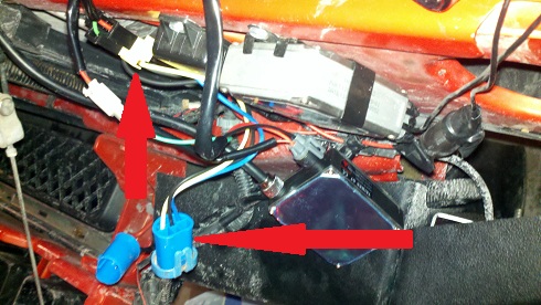

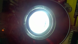

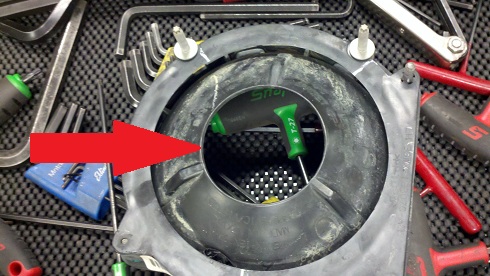

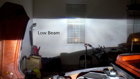

Hey Guys sorry for delay, got busy with the Holiday,
Here goes....

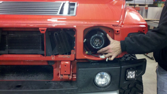

You will have to remove your grill to access and remove stock headlight.
The Headlight will fit but will need slight modification to the housing by way of dermal or similar device to make room for wiring (See Pic 2). You will also need an adapter 9007 to H4 (See Pic 3/4), other than that wiring is straight forward and works for both low and high beam.

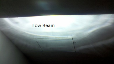

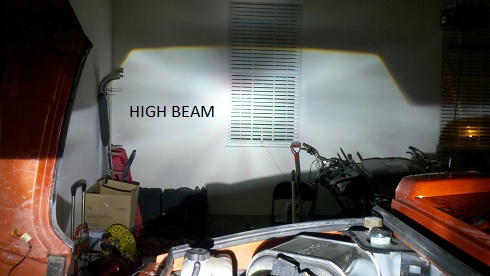

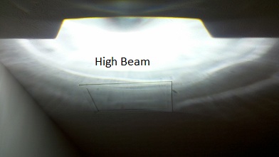

The light distribution is good and is very bright but does have a very distinct cut off as seen in the photos. I did have the headlight in the stock housing with pics from last week but somehow my Droid X did not save them so i just took these tonight of the light pattern.
I am sending back my Moderns tomorrow and having the Classics sent out which are now in stock. If you are handy it shouldn?t be a problem to install these... you definitely will need the 9007/H4 adapter and some modification to the housing.
I got my adapter kit from Summit Racing and is made by Delta and they are the only ones who make a direct adapter for a Hummer H2. This should work too... http://www.teakatoys.com/HUMMER_H2_S... /tl-96630.htm
If you guys still want to do group buy, let me know and i will have him set up that special website for us. I know the adapter is an added cost so just give me a general consensus of what you guys think.

What i learned is they 100% DO FIT, you need H4-9007 Adapter and I think you need a 55 watt ballast to be considered good for the classics. If you don’t care about DOT compliance, then i think Moderns are the way to go. Obviously the color does matter of the light, 5000-6000k being the ideal colors. I am undecided if i am going to keep these or return them. I am not crazy about having to modify them to make them good. Please message me with any questions.
