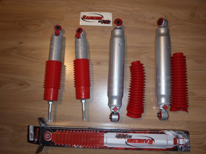

Old 02-23-2011, 10:53 AM
wingn69's Avatar
wingn69 wingn69 is offline
Join Date: Aug 2008
Posts: 490
Default Re: one more Rancho RS9000XL question??
Just sharing a photo of the shocks...
