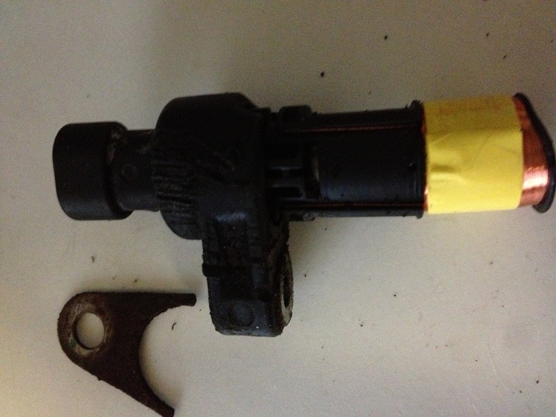

so a few months ago, i took my H2 in for regearing to 4.88s
long story short, the shop (Burnsville OffRoad) damaged the pass side rear ABS speed sensor ( unsure about drivers side yet)
part is $200 and special order!!!
im pissed right now, and in a time crunch as the part wont get here till next week
i guess im more mad at the cost and the availbility of the part
2003 Black Hummer H2 Adventure Package

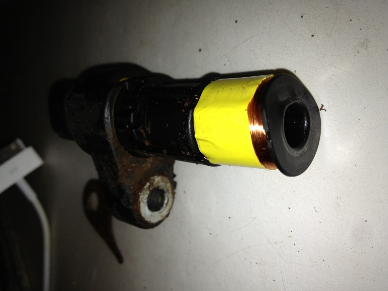

need some help here.
well after visiting the autoparts stores, and looking online to compare prices, the images arent matching up.
this is the part that came out of my H2. noticed where it was pushed/crushed
now what i found online, and the image that shows up when visiting the autoparts store is this http://www.stylintrucks.com/parts/ac...9215rear.aspx#
or
http://www.google.com/imgres?q=AC124...r:25,s:0,i:171
obviously i knwo images may not be the same part i need... but i havent found an image for anything like the part i pulled out of my H2... anyone got any info?

so just checked the other side,and that sensor came out in 2 pieces.
so this just turned into $400 for new sensors so i cna get my ABS and TC2 back and have 4x4 LO ability again.
im just hoping i can put these new sensors in and everythign works without any issues.
worst case if the diff needs to be taken apart, it will deffinitly be heading back to the shop and alot of bitching going on

well had something short of a wet dream.
so if you need to replace your rear ABS sensors, and you pull your sensors or looking like the pics i posted above... well your halfway there.. and you just did the easy part.
the othe pics i posted, that is teh actual part. that aluminum sleeve part is still stuck in the hub.
with enough twisting, crushing, prying they finally came out. dropped in the new ones and started the H2 up.. there were no lights on on the dash...
took her for a short spin dropping it in to 4LO, HI and locked up the rear diff... it was great finally getting that fixed.. granted at the cost of $400...
