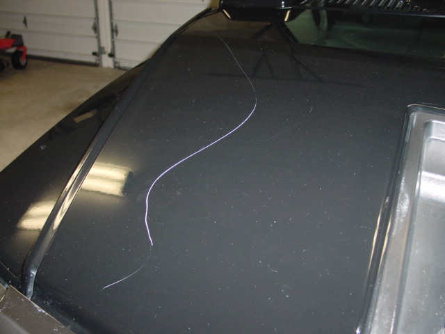

i was wondering if anyone has had their truck keyed and had to get repainted , some lil ****ers keyed my car at school on the hood and its all the way down to the metal and i got to get it repainted , if u had u car repainted i was wondering how much its gonna run , just like a estimate , thanks

Down to the metal on the hood?

Even if you have it fixed, the match won't be the same. You'll have to insist they do the whole hood.

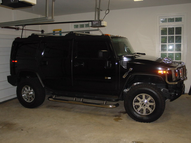

yeh im pretty pissed , ill post a pic of it for you guys , i live in macon,ga by the way..

That would be tough since the hood is made of fiberglass .

yeh im 17 too . sry i wasnt thinkin , the hood is made of fiberglass , my bad

Make sure they do the whole hood, and blend it in with the rest of the body panels. Don't just let them take the hood off, and do it alone. Make sure they also remove your chrome and other bolt on stuff, and don't just let them tape it off, it will eventually peel at those points if they do! Get it done right, or it'll have to be redone later!

well i just went i got a estimate at the body shop and its 433.00$ to get fixed but im readin the line items and descriptions and it seems that they are taking the hood off and my brushguard and just doin the hood , so i guess ill have to give them a lil talk..
