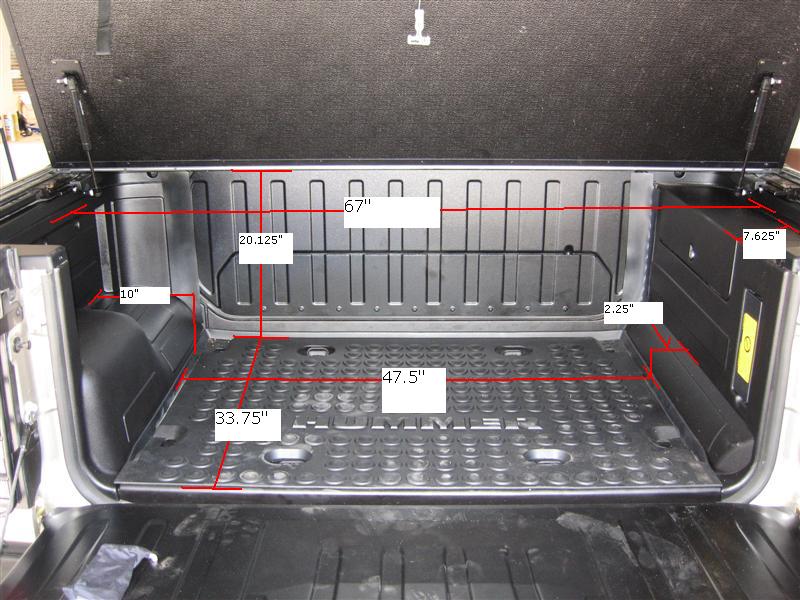

Just a quick question. Thinking about an SUT (leased) instead of an F150 FX4 (buy).
Will a motorcycle (dirt bike) fit in the bed with the midgate and tailgate down? I was wondering if the front tire/fender would fit under the roofline against the folded backseat.
I don't want to trailer them.
I have seen them attached to the roof at a 45 degree ange, but that just looks like a hassle to load.

not going to happen. I wondered myself, but I do not think it would be a good idea to even try. what is the wheel base of your bike(s)? How far out is the tip of the front tire from the handle bar/headlight area?

Bike is 7' long. midgate down and tailgate up says the bed is 6"0. So my guess is that with the tailgate down the length would work. Just don't know if the tire will fit under the roofline.
Fender could be removed, but I don't know the height of the tire vs. the opening in the midgate??
Just looking for anyone who may have tried it. I really want the SUT but might have to stick with a traditional pickup for "practical" reasons, which suck!

To do that you'll neeed to remove the spare tire and carrier. The carrier swings out way to the right when opened far enough to drop the tailgate. FWIW, you'll also not be able to install a tonneau cover.
<BLOCKQUOTE class="ip-ubbcode-quote"><div class="ip-ubbcode-quote-title">quote:</div><div class="ip-ubbcode-quote-content">Just don't know if the tire will fit under the roofline. Fender could be removed, but I don't know the height of the tire vs. the opening in the midgate?? </div></BLOCKQUOTE>
The rear window height is slightly more than 12 inches. Combine that with the variables you already know and the specs in the picture below and you should be able to calculate your answer.
<BLOCKQUOTE class="ip-ubbcode-quote"><div class="ip-ubbcode-quote-title">quote:</div><div class="ip-ubbcode-quote-content">Just looking for anyone who may have tried it. I really want the SUT but might have to stick with a traditional pickup for "practical" reasons, which suck! </div></BLOCKQUOTE>
I do believe you're pioneering this one.

WOW! Great measurement pic, THANKS!
I don't want the trailer because I have nowhere to store it. Bike needs to go from the garage to the truck.
As you can see I am really trying to make this work. I want the SUT, but not sure if it is really practical as a true truck.
