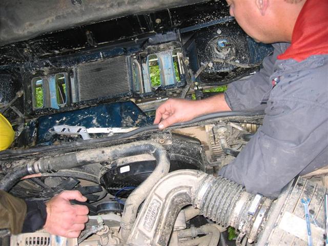

Old 08-12-2005, 05:52 PM
You can use GM fans for the 2500. They're dual electric and also have an outer ring attaching all the blades together. It makes for a more sturdy fan body, then the Flex-a-Lite.
This is a pic of my experience after hitting water with the Flex-a-Lite. The right one shredded.

Ken
I have a 05 SUT and I'd like to install an electric fan. You said "You can use GM fans for the 2500". How about the fan shroud? Is that from a GM 2500 or are you using the Flex-A-Lite.
This is a pic of my experience after hitting water with the Flex-a-Lite. The right one shredded. </div></BLOCKQUOTE>
Old 08-29-2005, 01:53 AM
Posts: 1,784
2500 Fans come with it's own shroud. It is complete except for the wiring harnes from Nelson Perf. You then need to have it programed at dealer to tell fan when to come on and go off. I use the coolest setting.
