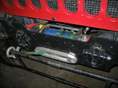

the front. I think the smaller fairlead is much cleaner looking and a must for synthetic rope. Shawn at Angry Iron sells Amsteel in a cool green color now. Mine is blue, the green you see is a 10ft. abrasion protection sleve. I couldn't re-use my hook from the old cable because it would not fit on the end of the amsteel rope -- I just use a D-shackle. I got 100' of 3/8 amsteel rope and the fairlead from Willysoffroad for about $230.
