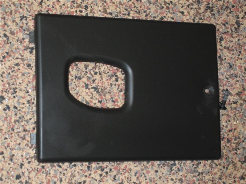

Steps to removing the door panels.
1. One phillips head screw holds on the plastic trim panel behing the door handle. Remove the screw and then the panel.

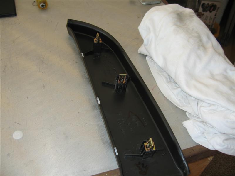

2. With the panel off, note the two 7mm hex head screws above the handle. Remove the two screws.

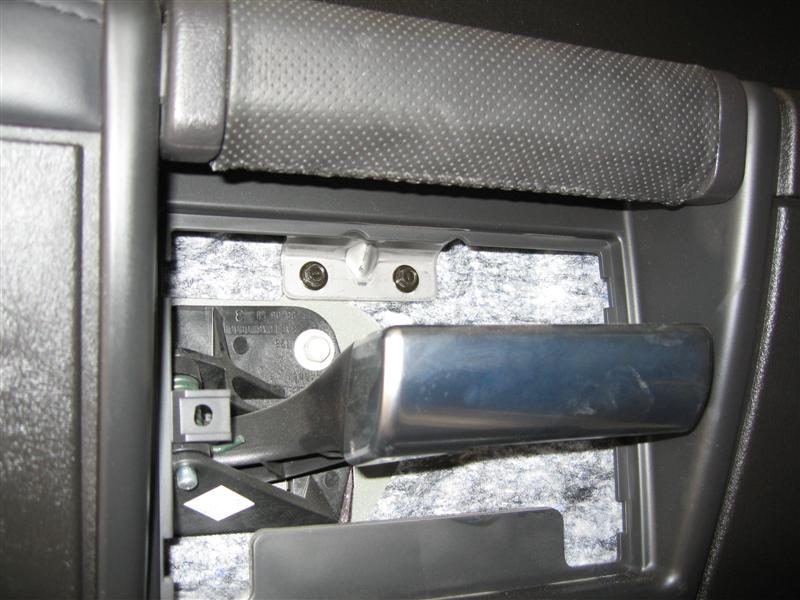

3. The door panel is now held in place by plastic fasteners. Work your fingers under any edge and pull straight away from the door. Brace against your pull -- once one lets go, they all tend to want to let go. If you let that happen, it'll put sideways stress on the remaining fasteners and break them.
You can see the fasteners in this picture. Some are black, some are white. (The gray insulation is pulled back and foam cut in this picture because I was replacing exterior door handles.)

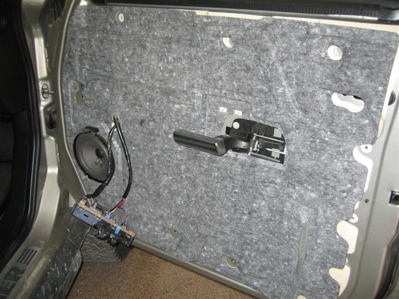

A more accurate view of what you'll see with the panel off. This is the front passenger door. Note that the wires are grouped in a series of plugs. You probably won't need to take the panel all the way off. Note in previous picture the inside pull handle is tied to the wheel to hold it up.

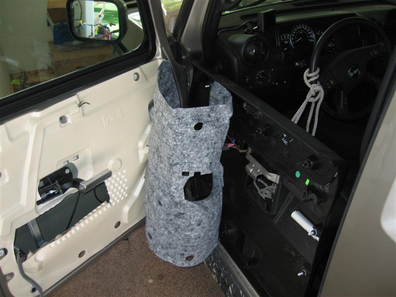

4. Rear door panels require one additional step -- you must remove the narrow, vertical plastic that's aft of the window. It's held on by fasteners that you can see in this pic.

Take a look at the fasteners in pic 3 -- see the black "collars" around each fastener? That's part of what insulates the panel from the door. The insulators are about 1/4" deep and slide off the fasteners way too easy. If your door panels have ever been off (they may very well have been removed at the dealer before you bought the truck) and you're having lots of squeaks, I'd first check to ensure you have all the black insulators.
Check the two screws in pic two above. Are they tight?
