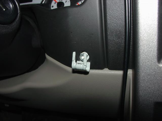

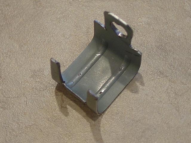

Now for a hook on the dash. I tried to get it to hand with some heavy coat hanger but I just wasn't talented enough to shape it right.
So instead it wandered the house looking for some raw material I could do something with.

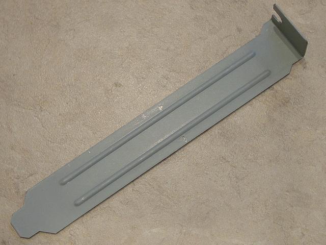

Can you believe that there is an alternative use for these computer expansion slot bay covers that you just toss in a box when you add adapter cards to your computer?
'03 pewter base H2
Old 02-23-2006, 03:55 PM
ree's Avatar
ree ree is offline
Posts: 1,260
There is. This is what I made with my dremmel and pliers.
'03 pewter base H2
ree's Avatar
ree ree is offline
Posts: 1,260
And it mounts to the dash under one of the dash bolt heads like this:

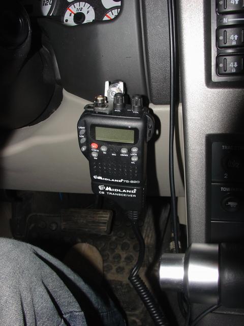

This is the handset hanging on that hook.
It's an aluminum hook so it could be bent if you really pushed/pulled on it, but it's pretty small and out of the way. And I filed the edges a bit so that it's not rough on you if you drag your hand across.
Best thing is I can simply remove it if I come up with a better solution.

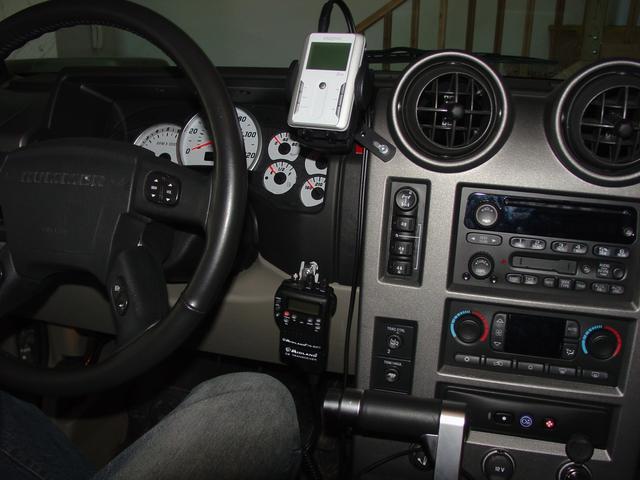

And this is the view of it from a bit farther back.

Looks nice. I put my CB in the same place but I don't like it. It's in the way of putting key into the ignition and I can't see the display when driving. I plan to move it soon. I'm going to fab a bracket off where you have your ipod.

Mine hangs low enough not to be in the way of the hands when putting the key in, but visibility is poor. My hook is loose enough to allow me to reach down and swing it upward a little and see the LCD through the wheel spokes though, so it hasn't been too bad.
