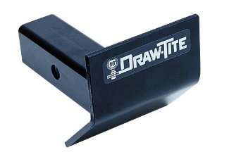

The etrailer plate looks good, but remember the front receiver hole is vetical. AL

01-10-2003, 04:41 PM
Posts: 114
So how do you think the Hidden Hitch plat gets afixed. It looks like it requires a horizontal bolt. I thought the front H2 trailer hitch only has a vertical slot for a bolt?
01-10-2003, 05:08 PM
Location: Aruba
Posts: 349
1. I think the Hidden Hitch plate has two 2" vertical "angelwings" on its back (of which you see only one on the pic) which fit into hitch receiver. Indeed this poses a problem, because the locking pin goes vertically into the hitch receiver. Oh oh!
If only a welder could afix two horizontal pieces (with "pin" hole) as to create a square which fits into the receiver...
Real enthousiasts work going on here.
2. Only if there is a brush guard installed one should beware of obstruction of a(n eventual) license plate holder sticking out of the hitch.

Alternatives for front hitch license plate holder:
1. ttp://www.etrailer.com/Merchant2/merchant.mv?Screen=PROD&Store_Code=E&Product_Code= 6771&Category_Code=FMH
But this needs modification:
a)Drill vertical hole
b)Dril license plate hole
2. Found a local welder (husband of my technician AMOF) who's going to design and construct s'thing 4 me. Will let you know.
01-10-2003, 06:09 PM
Posts: 114
What I don't understand is: If these pieces are designed for the front hitch why don't they all have the vertical pin holes? Did Hummer go a different direction with their front hitch design? I assumed that all trailer hitches have the horizontal pin and all front hitches have the vertical pin.
Also, I have a hitch attachment for bikes and such. I though I could use it on the front hitch but I guess I can't because of the pin placement.

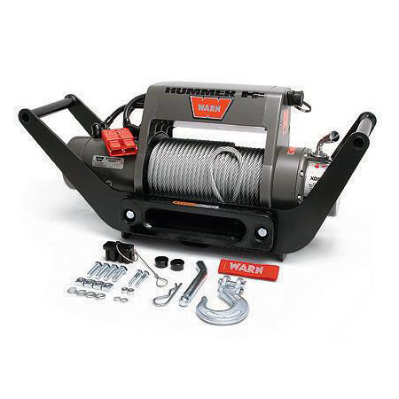

Was wondering: Is the front hitch receiver of the H2 designed for the soly use of the (WARN?) winch only then?
Someone made a remark earlier that the hole on top middle of the bumper is intended for (long?) pin to hold the front winch.
In that case could that same pin be used to lock other hitched accessories?
Like a bike carrier, in which you'd have to drill a vertical hole BTW.
Or even a license plate holder?
Who knows more?

Location: Aruba
Posts: 349
If used in the front hitch reveiver:
Will that pin be long enough?
And where's the part (hitch) which goes INTO the receiver?
Anybody who got this setup, please be so kind to describe.

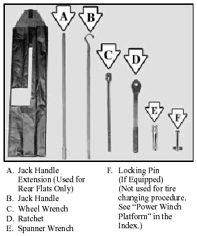

01-15-2003, 12:58 PM
Posts: 1,216
JCJ-The pin that comes with the set-up will not work. Use the pin that comes in your Tire Kit.
01-15-2003, 01:52 PM
Location: Aruba
Posts: 349
Big Z. Thanks.
Part F? Page 5-20 of manual.
My H2 didn't come with that nor the hitch receiver extension!
