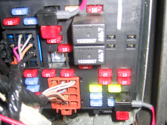

I finished wiring the lights for my front bumper yesterday and found a couple of things at the Auto Zone that made life very easy. These were jumpers to create an extra circuit from any fuse in your fuse box. They plug into an existing fuse socket and you plug that fuse into them. They then have a socket for another fuse and a wire with a crimp connector for another circuit. This is the easiest way I have found to attach to switched power from the inside fuse box.
In the pictures below the first picture is of the entire fuse box with two of these devices installed. Look for the red wire in the upper right hand corner and the lower right hand corner. This is what they look like when they are installed. They provide for a neat solution and fuse protection for your circuit.

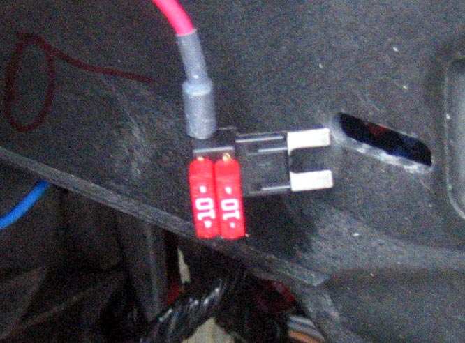

This second picture is a close up of the device where you can see the two fuses and the wire for the second circuit. I used one for the trigger to my fog lights in the bumper as well as the lights on the Gobi rack. This circuit is switched so when I turn the ignition off it turns off the lights. Thus preventing me from accidentally leaving them on.
