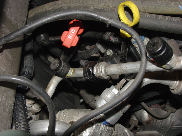

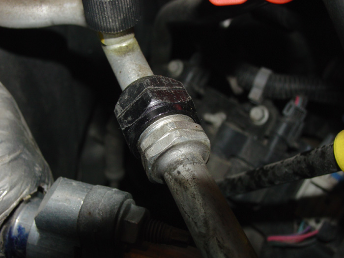

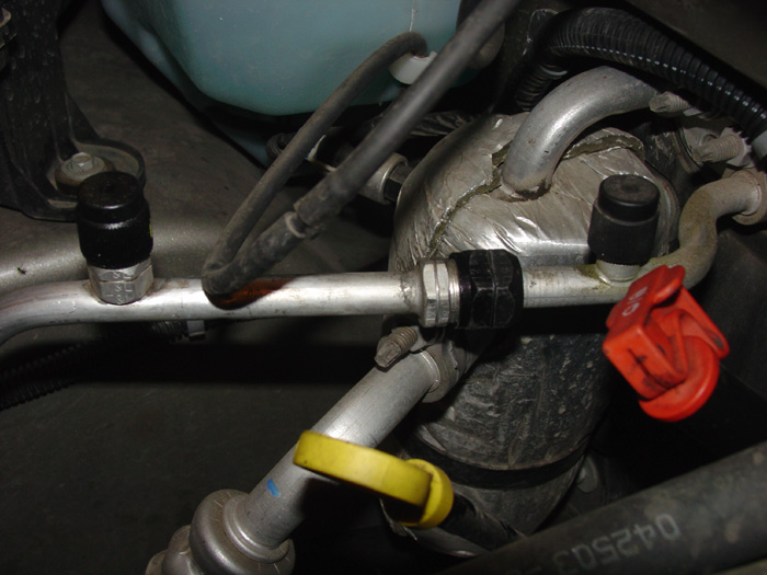

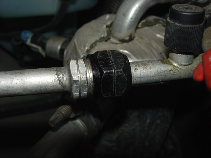

Turns out that certain Yukons and H2's have a service bulletin that pertains to the orifice tube being put in backwards from the factory.
He evacuated the system, turned the orifice tube 180 degrees (normally they're suppose to go in one way only... the arrow should point towards the front of the truck) and the AC works perfectly.
