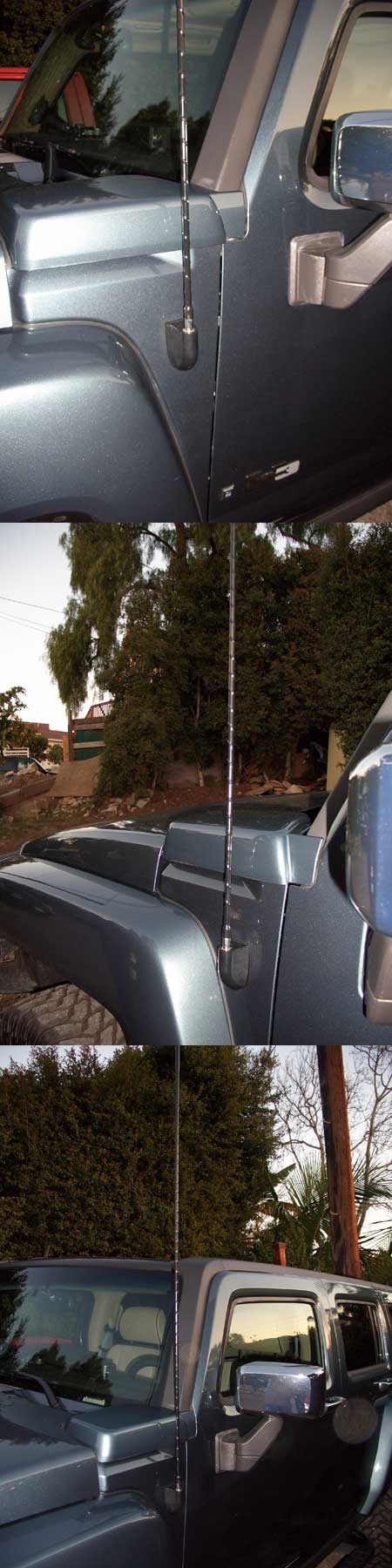

Hope these shots help, couldn't get a good angle.
one cool thing, is that you do not see it when driving, the A pillar hides it very nicely.

<BLOCKQUOTE class="ip-ubbcode-quote"><div class="ip-ubbcode-quote-title">quote:</div><div class="ip-ubbcode-quote-content">Originally posted by BABHUMV:
Got the antenna mounted. It now offsets the factory radio antenna by being mounted on the opposite side in the same location on the fender. Ran the antenna wire from behind glove box, out a grommet hole in the frame above the front door hinge (silicon sealed the grommet when done) up and over the top behind the cowling trim and into the other side fender. This way it was invisible and does not interfere with anything. </div></BLOCKQUOTE>
- do you have a pic from the side?
thanks

I just installed the same CB. I just tapped into the power for the right CIg lighter socket. It is power on all the time and the wires are right there.
I have ordered a new antenna mount so I can mount the antenna on the left front fender in the same (but opposite) position as the radio antenna on the right.
I ordered a 4 foot Firestik so I can flag it when necessary, but I think I will order a 2 footer for around town.
Thanks for the great shots and info.
