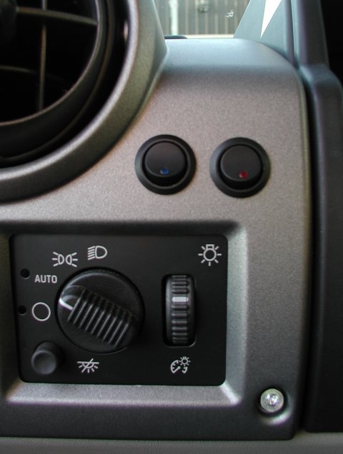

The other thing I would recommend is using the Pilot mini-round switches, would make it much easier to install in the place shown. A suggested easier switch location is in the grey panel to the lower right of the left air vent.
