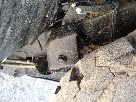

thanks. i heard from drmiles that you need to move the arm so it doesnt break when offroading. he posted this pic showing it. hope you dont mind drmiles!

So are you going to do it yourself or have the dealer do it. I am very courious to know because I want to get these tires but my draw back was that of the air ride sensors breaking. My dealer told me that you can not move them.
So it looks like this peice was moved from the front to behind? Is that right? If so How do you do it?
And do you move just the top part or the bottom as well?
So is that an aftermarket bracket and who makes it?

lol, to be honest, i have to talk to drmiles some more about it. im planning on doing it on friday. im under the impression that drmiles did it himself and that it was pretty easy.
he explains it somewhat to me at this link, http://www.kylebennett.com/showthrea...1&page=1&pp=10 its on the third page, that thread also has some pics of his ride with the same tire doing some offroadin. hope this helps you out some.

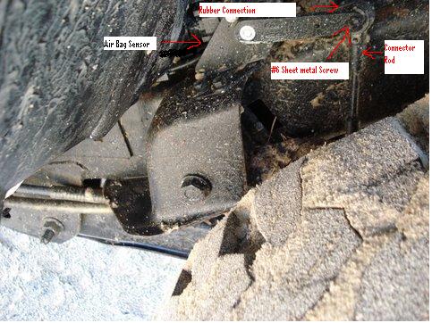

I'll try to explain. Been two years since I dun it. First the connector rod is attached to the lever arm on the sensor. On the outside it is rubber, on the insice is a hard plastic pin that travels through the center or the rubber piece. Mine broke the hard pin. I then drilled out the rest of the pin making a small 1/16th hole in the rubber piece. Then took a number 6 sheet metal screw, placed the connector rod with the hole in the rubber, on the inside of the sensor lever arm. Then secured it with the #6 sheet metal screw from the outside through the lever arm into the connector rubber end.
Hope that helps. It is easy once you get the arm apart
Also not sure but you should be able to pry the pin out with a flat head screw driver. Don't worry if you break it.

Hey look, I figured out how to use paint
Air bag Sensor = Ride height sensor

FYI, I broke the driver side twice, then broke both in one ditch before I figured out a fix.
Good Luck
