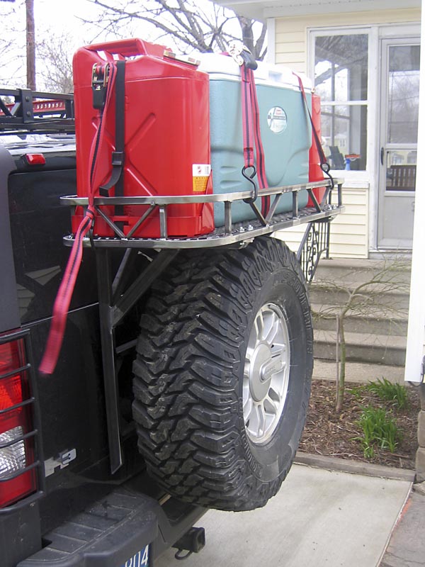

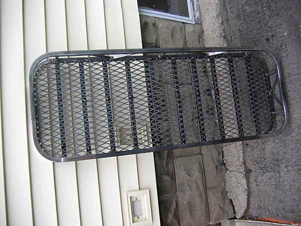

Picked up rack from fab shop, here's basket....
Paul M
SR1355

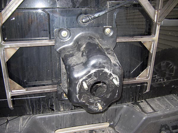

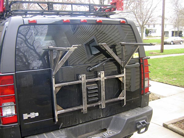

Old 04-04-2007, 11:40 PM
SR1355's Avatar
SR1355 SR1355 is offline
Location: NA
Posts: 478
Default Re: Jamboree Rack Design
Here's mount....
Paul M
SR1355

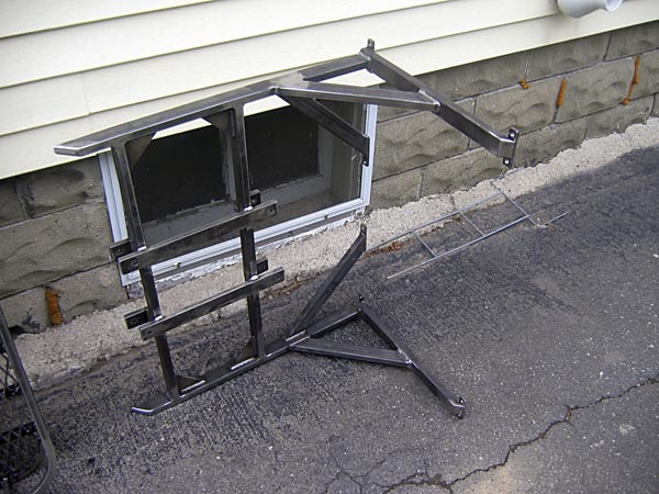

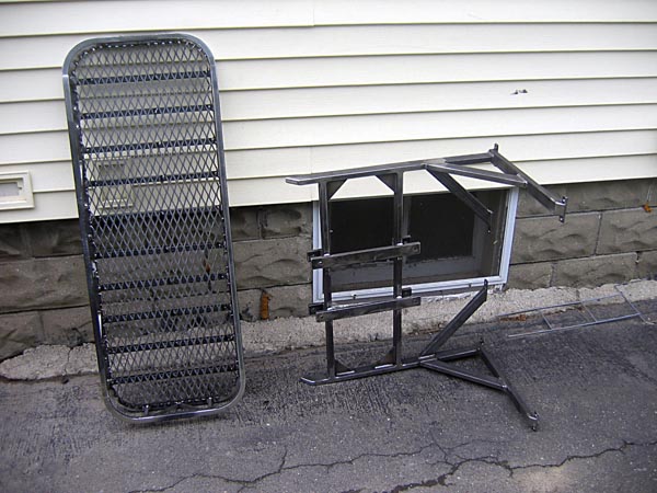

Old 04-04-2007, 11:41 PM
SR1355's Avatar
Location: NA
Posts: 478
Here's basket and rack....
Paul M
SR1355

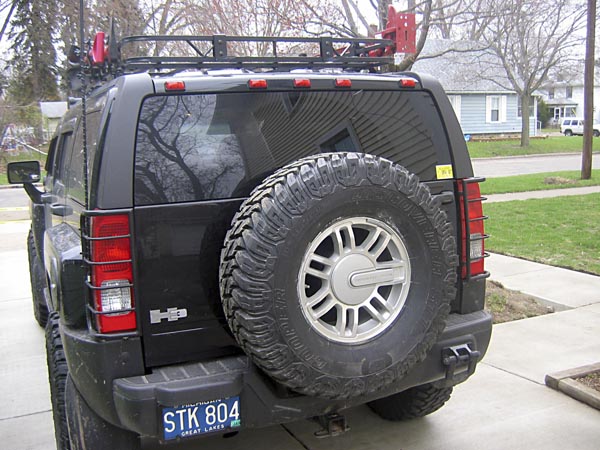

Posts: 478
Here's before shot of back of H3...
Paul M
SR1355

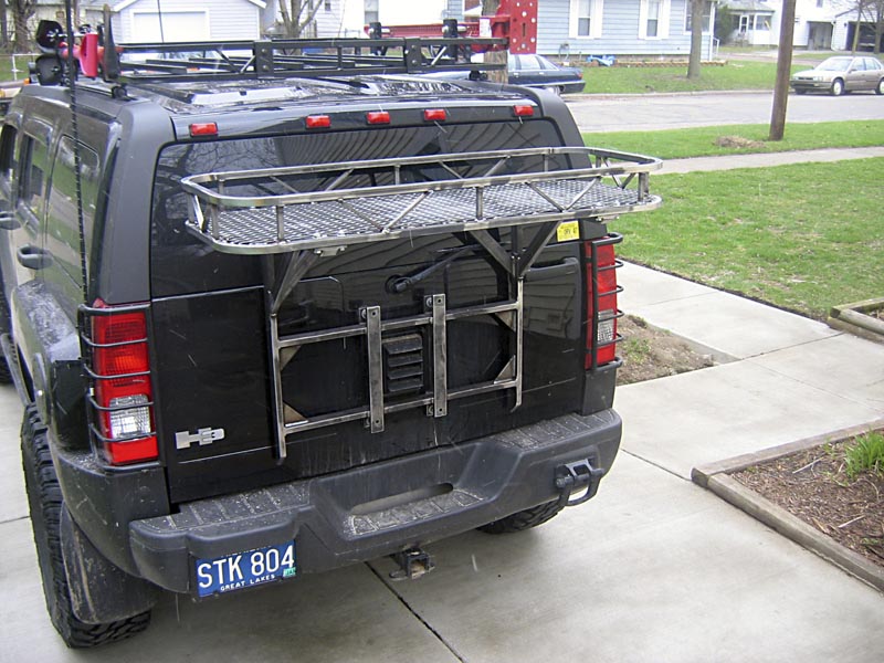

Old 04-04-2007, 11:42 PM
SR1355's Avatar
Location: NA
Posts: 478
Rack mounted....
Paul M
SR1355

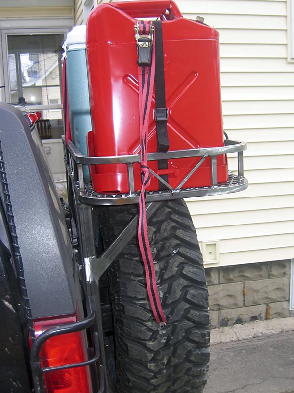

Old 04-04-2007, 11:43 PM
SR1355's Avatar
Location: NA
Posts: 478
basket mounted...
Paul M
SR1355

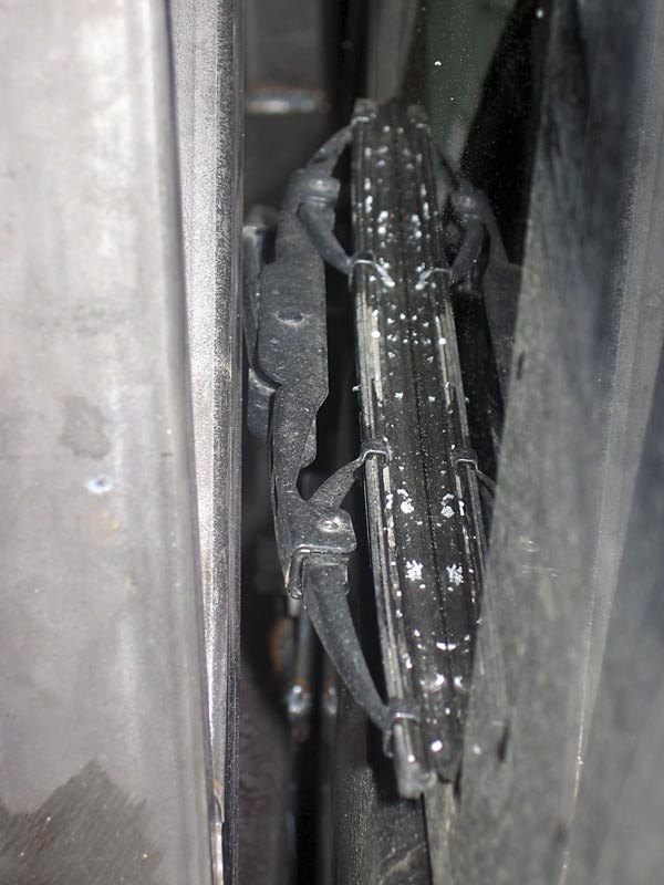

clearance on wiper...
Paul M
SR1355

Old 04-04-2007, 11:45 PM
SR1355's Avatar
Location: NA
Posts: 478
spare re-installed...
Paul M
SR1355

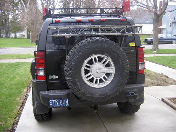

  #37
Old 04-04-2007, 11:46 PM
SR1355's Avatar
Location: NA
Posts: 478
completed...
Paul M
SR1355
  #38

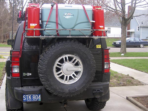

Old 04-04-2007, 11:47 PM
SR1355's Avatar
Location: NA
Posts: 478
completed 2...
Paul M
SR1355
  #39
Old 04-04-2007, 11:48 PM
SR1355's Avatar
Location: NA
Posts: 478
completed 3...
Paul M
SR1355
  #40
Old 04-04-2007, 11:49 PM
fourfourto's Avatar
SR looks great.
You just clear it on your wiper,not that is does much good.
A question: Hows the aftermarket hitch working out,do you get hung up offroading?
I dont know if I should get that type or get a custom one put in my bumper.Thanks
