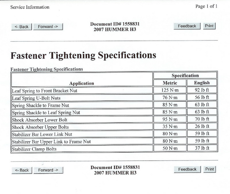

Originally Posted by SR1355
Have the rear plates in for powder coat so I'll be installing in a few days. What is the correct spec for the u-bolt torq? Info would much appreciated.
We looked this up for an 06 and 07 hit the print button on the 07 but they are the same.

I think I remember someone here had Amstar ones put on by a dealer and was told they had to replace the U bolts too be cause they stretch when installed.
Something to look into.

Whatever the individual decides. If that gives someone piece of mind by all means do so. They probably would if ask not recommend you go offroad and bash about over rocks and run the vehicle thru gritty mud and sand as well. I believe GM built the H3. I have noticed Amstars web site is still back under construction. Local spring shops are the best source for ubolts replacement. I had about 3000 miles on mine when I installed the skids. I did not replace mine. The springs have not fallen off.

Thanks for info Hunner... I torqed them to 60 the other night so a littel over spec.
