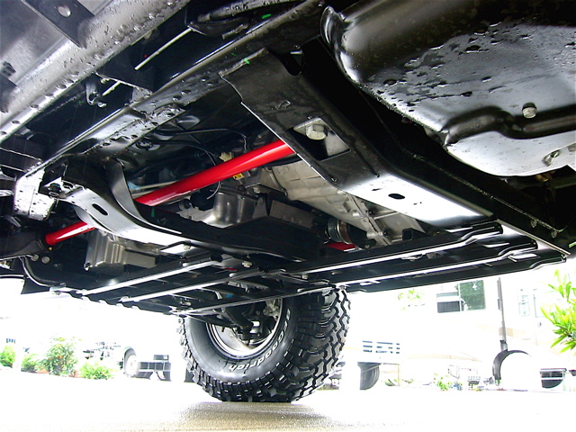

Excellent. Here are some pix, for what they are worth. I never did measure the stock height. Anybody know what it is? Didn't have my camera during the install so, like I said the pix are probably worthless. Next up, exhaust. Anybody have any suggestions. I am looking for stainless, and same exhaust note as stock... probably ain't gonna find that.

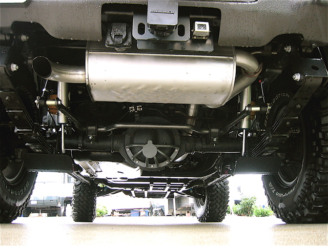

Default Re: New Torsion Bars
Shackles, and some other stuff in there.

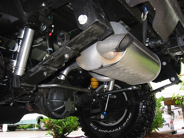

Another angle. I'll get some before and after pictures of the ride height this afternoon. Let's see some pix when your done 6'er.
