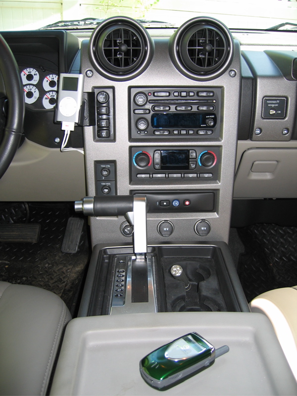

Old 05-21-2004, 06:37 PM
TouchdownTN TouchdownTN is offline
Location: Jellico, TN
Posts: 152
TouchdownTN is off the scale
Here are the pics after the installation of the AAI-GM24 and C2A-GM24. As you can tell not alot of difference. The cable for the Ipod that you see goes to a Belkin car charger with a mini-plug audio out. I have my Monster Cable plugged into this mini-plug and to the AAI-GM24. I ran the other aux in cable down the center console and it is tucked in behind the trim panel so I can get to it when I add the XM Roady or other Satellite Radio device. BTW, the cable for the Ipod is plugged into the rear driver's side power point and runs under the console up thorough the storage bin. We drilled a small hole for the cable to pass through. So when I take the Ipod out the cable is hidden. As far as the sub box, I just have to remove the speaker wire from the box and everything is back to factory again. I would really rather have the JL Audio stealthbox but don't feel like it is worth the money. Here are the pics

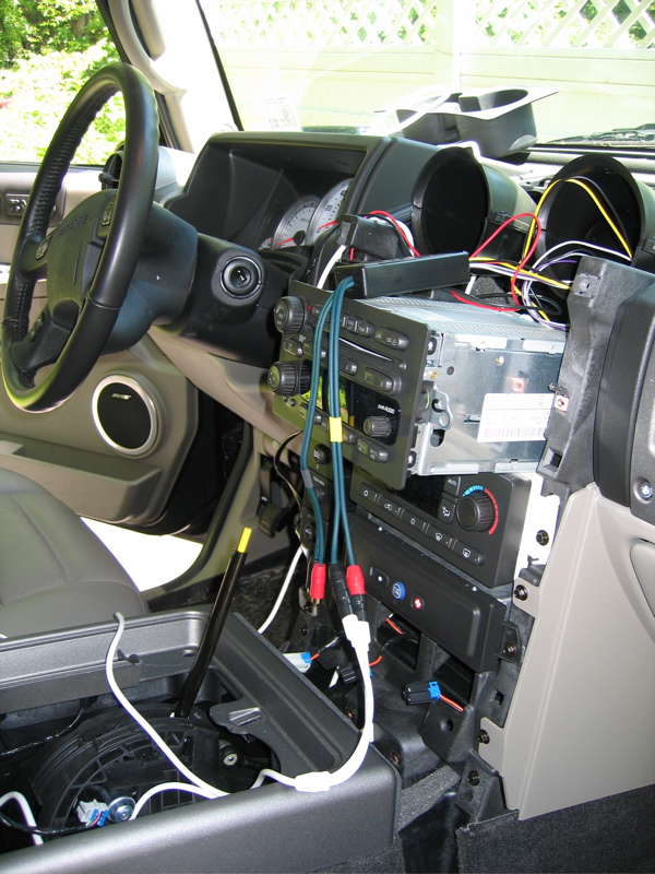

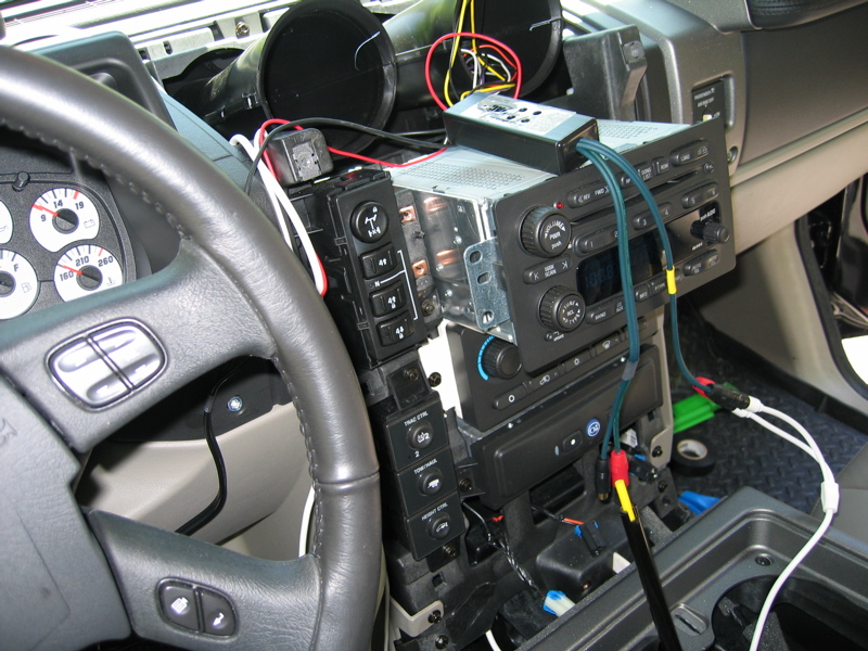

Old 05-23-2004, 01:30 AM
jwm3 jwm3 is offline
Posts: 22
jwm3 is off the scale
1/4
Old 05-23-2004, 01:31 AM
Posts: 22
2/4
Old 05-23-2004, 01:33 AM
Posts: 22
3/4
Posts: 22
4/4

Old 07-14-2004, 06:50 AM
VU VU is offline
Location: Honolulu, Hawaii
Posts: 36
VU is off the scale
Hey, does anyone know where to get the jack in the picture from for your ipod.
It makes everthing look so nice and clean. Also where did the holder come from for the ipod.
I wanted to get all the info before I set up with the Ipod in my Hummer.
Then off to put one in the Mini. haha.
Vu

Old 07-14-2004, 07:32 PM
Posts: 152
Don't know about that particular "jack" I use the Belkin Ipod Charger. I have it plugged into the rear 12V on the drivers side of the console. I then ran the wire up through the center console and out from the lid. I did have to enlarge a hole in the tray that sits in the center console. The Belkin charger plugs into the bottom of the Ipod. Where the charger plugs into the 12V it has a mini-plug to run the miniplug to RCA cable to the PAC device. I just ran my mini-plug to RCA cord through the center console and out of the back of the console to the Belkin charger. As for holding the Ipod I bought the cup holder Ipod holder. Got it on ebay for about $20 incl shipping. CompUSA carries both the holder and the Belkin Charger. Let me know if I can help you! My setup looks just like the ones in the pics above except for keeping the Ipod in the cupholder mount.
