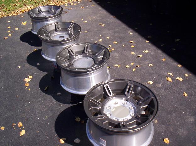

here is a shot with flash, and then one without.

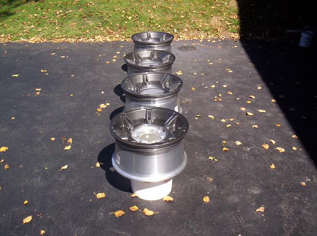

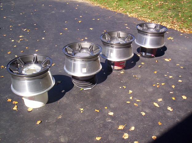

ok here are some more pics.
The one without the tape in the center has been done and dried the longest - that is why it appears slightly darker. All the others will darken as well. Enjoy the pics!

2

3

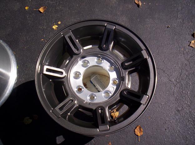

last

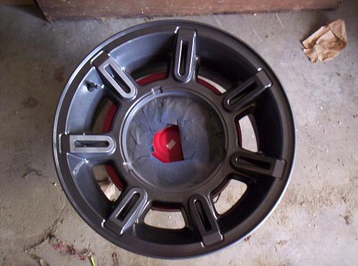

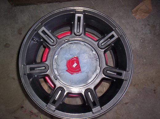

Since I posted the first pic, the sun has baked them all to the same darker color!
Also the centers are painted the same color. They need some clear - so I am waiting on Napa to open. As I am out of clear - again.
