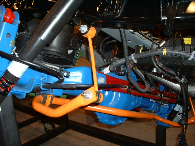

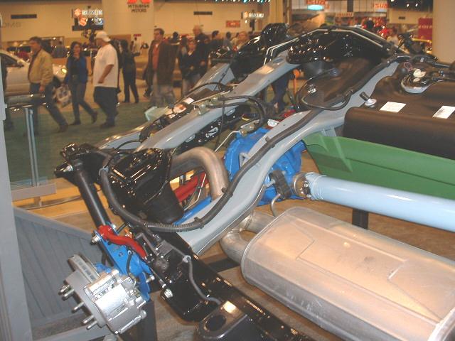

Here is a pic of the rear sway setup that I took of the display @ Houston Auto Show. Those JKS QDs might adapt pretty easy to the H2s rear sway Mike.

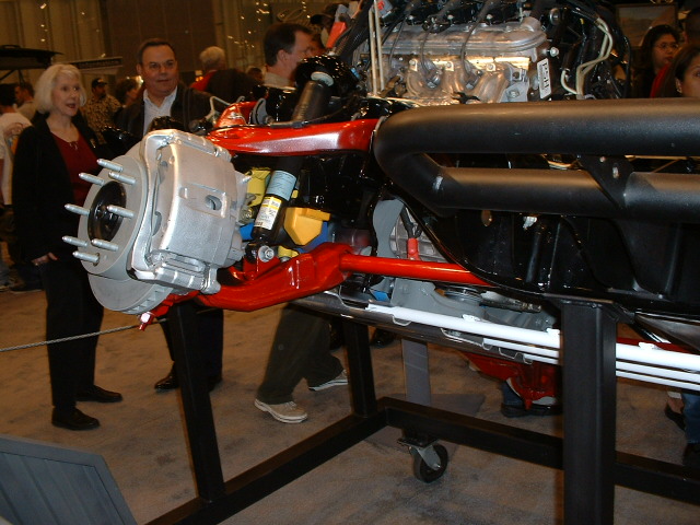

IFS means Independent Front Suspension (which H2 has). SFA stands for Solid Front Axle ( like on Mike's Jeep Cherokee).
Here is a pic of the H2 IFS. You can see the front "A" arms and front torsion bar in red in this photo.

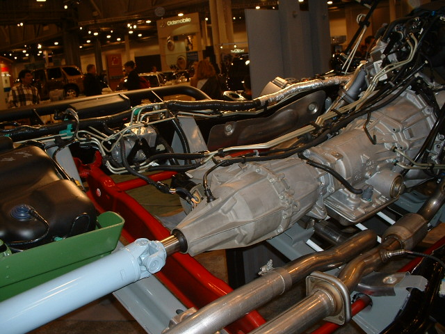

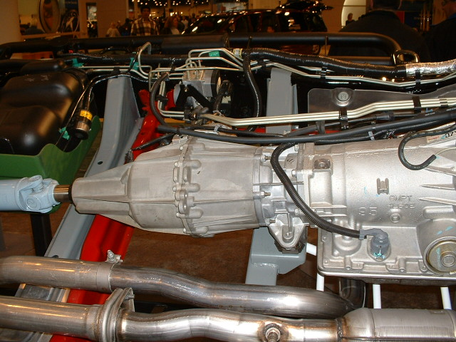

JJ... I think I understand your question alittle better now. There is no such thing as independent fourwheel drive that I know of. We are talking of Independent Front Suspension.
H2 has a fulltime 4 wheel drive meaning that it is always in 4 wheel drive, usually in 4 High Unlocked Mode, meaning that the differential inside the transfercase is unlocked. This will let the front and rear driveshafts turn at different speeds as the vehicle goes around corners and over uneven terrain. If the vehicle were on a slippery surface like ice and the transfercase was unlocked as soon as one wheel lost traction the truck would not move were it not for the Traction Control/ Anti Skid System and the brake computer, just like when one wheel on a 2WD without posi traction looses traction. When the transfercase differential is locked in 4 High Lock or 4 Low Lock both driveshafts have to turn at the same speed as they are locked together inside the transfercase.
The transfercase can be seen in this picture behind the transmission (pretty big isn't it). BTW the thing on the frame rail with all the lines is the control for Anti Skid/ Trac Control.
Hope I made this explanation clear.

Your right JJ. The H1 has 4 Wheel Independent Suspension. The first H2 prototype had 4 Wheel Independent Suspension as well but was changed to IFS with Solid Rear Axle when the H2 went into production.
One more shot of the frame display. This view shows the electric shifter motor (black thing with the wire harness on it) on the left side of transfercase. The small black thing with wire harness at top center above driveshaft is the speedo sensor.

Don, after looking at that pic of the rear sway setup you posted, I agree with you. I'm sure a set of JKS links could be adapted to fit pretty easily. The links are straight,and are pretty long. Most JKS links are adjustable for length to accomodate different lift heights.
Another thing to figure out is what to do with the swaybar once it's disco'd. On Jeeps, you can just tuck it up and out of the way. Doesn't look really possible with he H2 setup.
I have another suggestion though, after seeing the pic. Most setups I've seen have the swaybar bolted to the frame, and the links bolted to the axle, not vice versa like in the Hummer. It looks like it's just waiting to get snagged on something, hanging below the axle like that. What I would consider doing is removing the swaybar altogether before you go on a wheeling trip. Ubolt the 2 bolts per side that hold it to the axle, and unbolt the upper links from the frame.

Good point about the sway bar might get snagged. That was my first thought when I saw it for the very first time too. But then I thought about maybe the engineers left it down there for a reason, although they could have designed around the problem altogather. There are quite a few lines, wires, cables and a expensive air compressor & valving set-up above the sway bar. With the sway bar down like it is maybe someone will stop when the hear it draging on the rocks instead of continuing on and getting some more expensive parts snagged that are above it. Sometimes things are a trade-off when it comes to design and ease of production & costs usually win out.
Here are a few more pics of the rear and some of the more of the air compressor assy.& ride height sensors. It could be easy to damage in some cases, one of the reasons I decided to go with rear coil suspension, besides the coils were $1175 less cost and ride great.

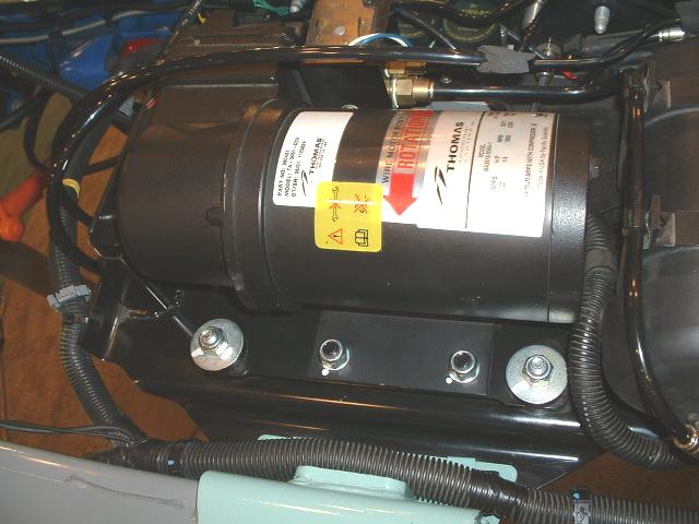

Heres one of the air compressor assy. and associated valving. I think the round object partly visible on the right to right of the compressor motor is a air drier/ filter assy., not sure though.
I was supprised at the size of the compressor. Larger than what I expected. Its rated a 11 amps. and 1/4 hp. motor.

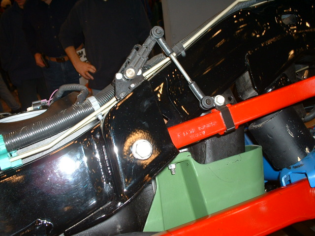

One last shot of the ride height sensor. It sits atop the upper control arm pretty close to the tire.
