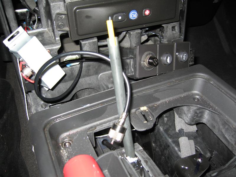

  #45
Old 01-16-2006, 01:34 AM
ree's Avatar
ree ree is offline
Posts: 1,260
Here's the current state of the project. </div></BLOCKQUOTE>
Ha, ha! Now you get to fuss with those little retainer clips on the bottom of the cup holder tray that slide around when you try to remount the damn thing That alone is enough to keep me from opening up my center console one more time unless it's a national emergency.
'03 pewter base H2

  #53
Old 01-16-2006, 04:31 AM
rodster rodster is offline
Posts: 1,571
rodster is off the scale
Progress!
The antenna is on, the coax is run and tomorrow I'll run power and ground, tune and then button everything up. If you own the Cobra unit (and if you care ) , you can see where I'm headed. After all this, I better be able to talk to my dad in Florida!
\'05 SUT
