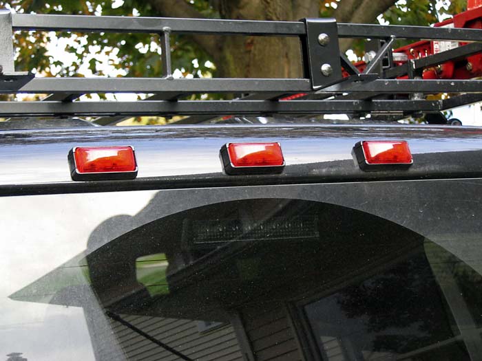

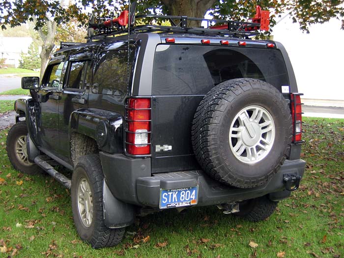

Default Re: Rear Roof Lights
Well, LED markers are final done. Problem with drivers taillight was blown fuse. LEDs are now wired into trailer harness.
Here's rear pic:
Paul M
Paul M
SR1355
  #57
Old 10-20-2006, 11:07 PM
SR1355's Avatar
SR1355 SR1355 is offline
Location: NA
Posts: 478
Here's close up of center three:
I'll take some pics later with them on.

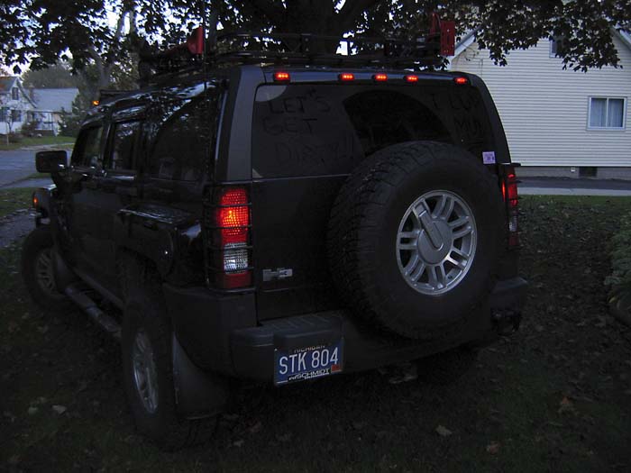

Well, it later:
Paul M
SR1355
