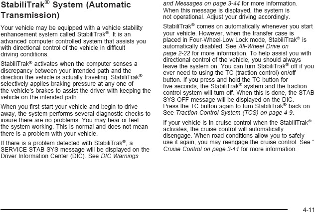

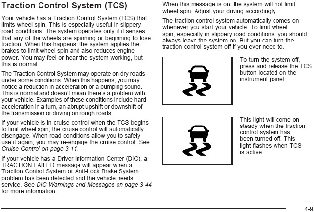

I was refering to the H3. This is the rightmost switch - picture of a car with squiggly lines underneath it. Hold it in for 5 sec and this will disable the traction control and the stability system (if you have it).
  #50
Old 10-28-2006, 11:21 PM
Default Re: Rear E-Locker
That is the stabilitrac switch. Different system than the traction control.
You cannot turn off the traction control

Here are two pages from the owners manual. You can get the electronic owners manual from www.mygmlink.com after you register.
That sure explains it
