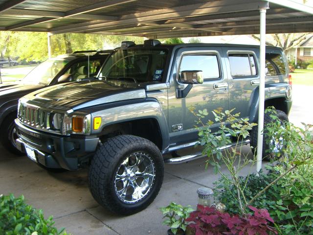

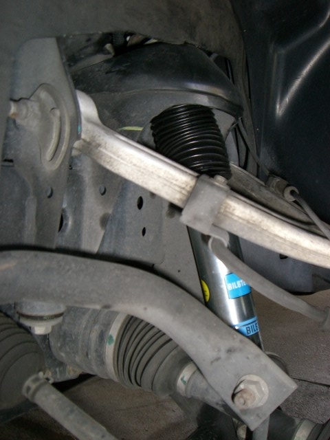

I had the same problem with my truck after the Truxx kit was installed. I also has some minor popping in the front end. There were some postings that explained that you could loosen the rear shackle at the leaf while on a floor jack, lower the rear and then tighten the bolt. This will probably give you that 1/2 inch. Some guys did it for the same correction. I just ditched the Truxxx kit altogether and purchased the Bilstein Cognito Leveling shocks. Yankee you can do one of the following:
Option 1: Crank down the t-bars a bit, about 1/4 inch, but u do not necessarily have to get another alignment bc the front end alignment should still be to spec.
Option 2: You can buy the rear shackles or the add-a-leafs to lift the rear, no alignment would be needed.
Option 3: Do the above on the stock rear shackles and get the 1/2 inch.
Here is a pic of mine with the Cognitos. Oh, and the front will settle in. I had to adjust my t-bars many times inbetween test drives. My front was sitting perfect at 24 1/4, I am now about 24 1/8.

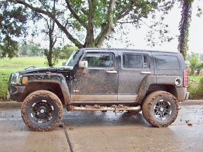

Does this make you feel any better Jared? This is my friends H3 with the ready lift. You can clearly see the front end is higher than the back.

Must be those Moto Metal 951's

Too Funny! I didn't even recognize that till you said it.
