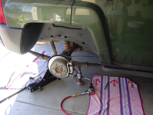

OK, so now I have the skids, have the shock skids painted and ready to install. I don;t think I can just remove the four bolts? or can I. I'm guessing that you cannot just remove them and need to get the axle jacked up to take the weight off of the springs?
  #71

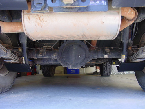

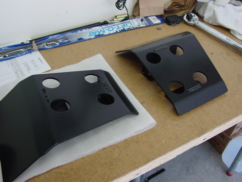

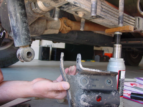

No long explanation needed. Just take off the U-bolt nuts and the shock bolt and put on the skid. You can get it all back up and then compress the shock to get it in. My friend and I did these yesterday in 45 min. I reccommend powdercoating! That was the first time that I had parts coated. DO IT!! It was 40 bills to do both plates. BEAUTIFUL!!!
I am glad I had my air system finally hooked up to rip the nuts off. Previous wheeling and abuse made them a bit tough to get off. Thank goodness I wasn't using a wrench.
