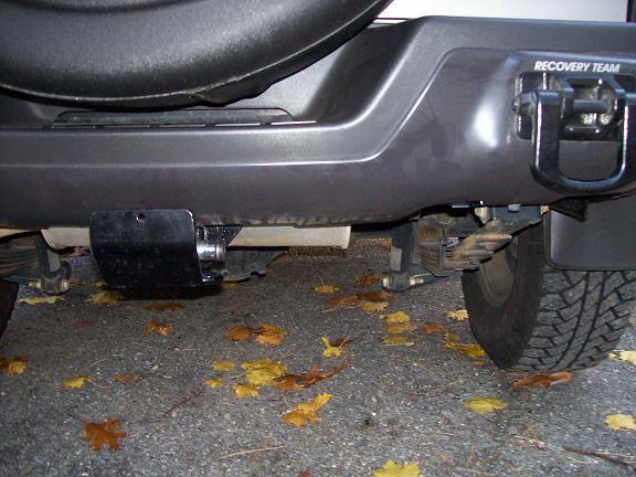

I recomend with your hitchweight of almost 500 lbs you use a weight dis hitch with double sway bars..
My hitch weight is only 290 lbs.
I have a aftermarket hitch(below bumper) with a 2 inch drop with a friction type swaybar on the right side only.
If you have a factory hitch you need a 4 inch drop.
Also my camper sits closer to truck then his.(If backing up I have to be carefull not to angle to the right to much or my hitch jack hit my tire cover,I upgraded to a electric jack because if unhooking when not lined up straight the handle on the jack would rub against tire cover)

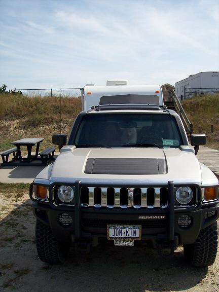

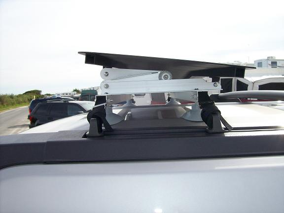

fourfourto 04-21-2010 11:40 AM
Re: H3 Towing & trans cooling
2 Attachment(s)
the deflector in the one pic.
its about 4 feet wide.
11.5 avg on my NM trip lots of hills
12.5 avg upstate some hills
13 flat ground.
That before the deflector.
I get a good 1.5 mpg better now with the deflector maybe up to 2 and notice its a little smoother going up those long steady hills.
Heres another pic from the side.
the 2nd one is in the down position for not towing, they recomend about apx 15 degrees when not towing so it doesnt cause lift:eek:
apx 45 when towing.
It comes with rain gutter hooks to mount at door opening.
I have it further back and use the roof rail tabs for mounting ,its a cleaner look.Attachment 52545
