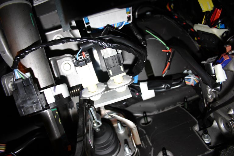

Here's a shot under my steering wheel. Hummer Customer Care said that my towing package did not come with the hookup under the steering wheel, and that I would have to hardwire it. That seems really silly, although I can not locate where I would connect the break controller too -- so it looks like I will be running a wire to the 7 pin outlet.
Old 08-23-2005, 10:02 PM
Ok, I'm not getting anywhere. I don't know how the wiring is done in the rear. Maybe check with f5fstop to see if he can find it on the H3 service info.
BTW, what is that red or orange wire that looks cut

Have you found how to install the controler using the quick connect harness? I to want to install one without having to cut and splice. I havent located the connection yet but they surley have one since there is a 7 pin plug installed with the factory hitch option.
Old 11-01-2005, 04:30 PM
Check the wires near the light for the footwell. I think I saw some wires labeled for the trailer stuff when I was installing my CB.
Old 11-01-2005, 06:02 PM
grayh3 grayh3 is offline
Posts: 11
grayh3 is off the scale
I do think that will work. I had looked under the dash but was looking more to the left where the wire loom came through the firewall. The wires are clearley labled and should be able to wire the controler directley to them, they are labled as follows. black (ground), red (AuxB+), light blue (Brake signal), dark blue (Trailer Brakes). I must make sure that the brake signal wire is on the cold side (ON only when the brake pedal is depressed) and that the red Aux wire has a circuit breaker in line. Thanks for the info it go to show four eyes are better than two.

You got it. The H3 is supposed to be wired for the brake controller and a trailer hitch wiring, regardless if you get the hitch package from the plant.
For a hitch they are up under the rear bumper in a taped bundle.
