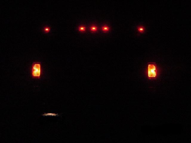

They are supposed to be connected to the parking lights. They come on when it is dark outside.

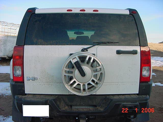

When I got my rear marker kit, it said to hard wire into the parking lights..

z, looks cool on the rear! hey, where is your tire?

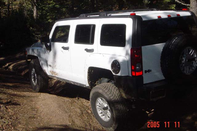

z, looks cool on the rear! hey, where is your tire? </div></BLOCKQUOTE>Ran over a branch on the trail and put a hole right smack in the middle of the tread. Time for some real tires...Waiting for my 315/75/16 baja MTZ as I write

where can i get one of those rear marker light kits? </div></BLOCKQUOTE>My brother puts the kits together and I test them for free. He's a jeep guy...LED lights

Z so the led kit is $90 and free shipping ? how hard is it to install and wire it up ? </div></BLOCKQUOTE>Yeah, it took me about 4 hours. Drilling into the hummer was something I took my time on. You have to remove all the swing door panels and then you have to drill a hole up where your rear brake light is then run the wire's down the inside of the door. I could have ran the wire on the outside along the top cover but I decide to do as the instructions stated.
Running the wires down the inside of the door was a little troublesome because the wire would get stuck on the curve of the door between the welding gaps. Removing the top cover was more difficult than removing the bottom cover...so if you ever drilled into a car you should be fine. The wire connections are simple.
