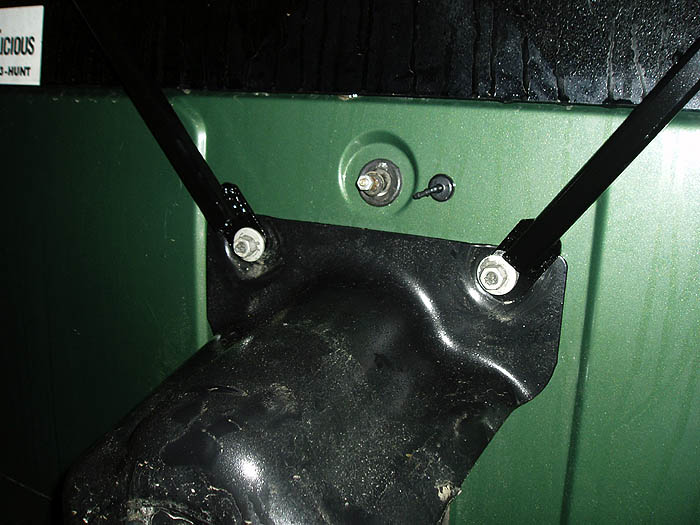

Default Re: H3 rear tire rack
Here's the door mount...3/4 steel square tube, tabs welded to the ends & drilled to fit. Top two bolts are exactly 8" apart, but the right-hand bolt sits 3/8" higher than the left one does...go figure, what happened to symmetry?
