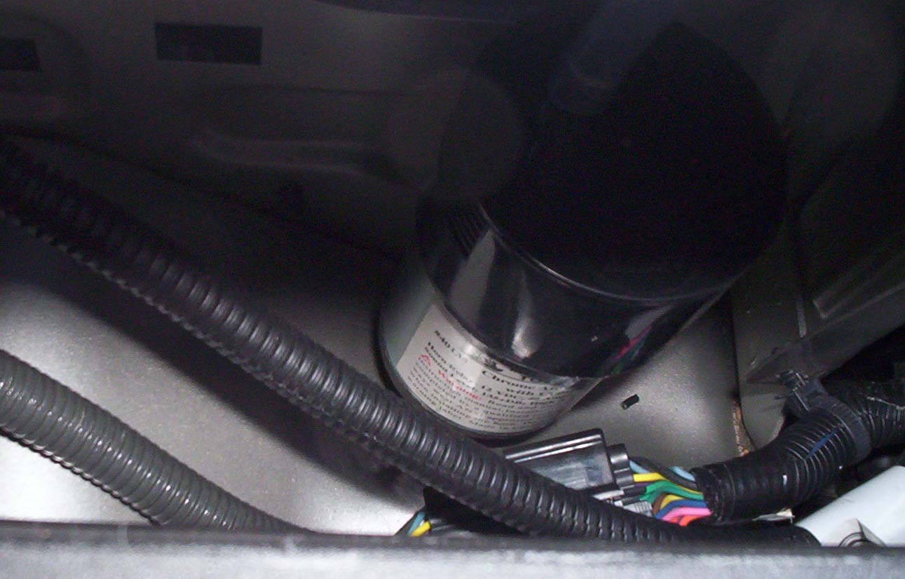

fourfourto's Avatar
Fed wire from relay through firewall
Old 11-20-2005, 04:40 PM
fourfourto's Avatar
inside view

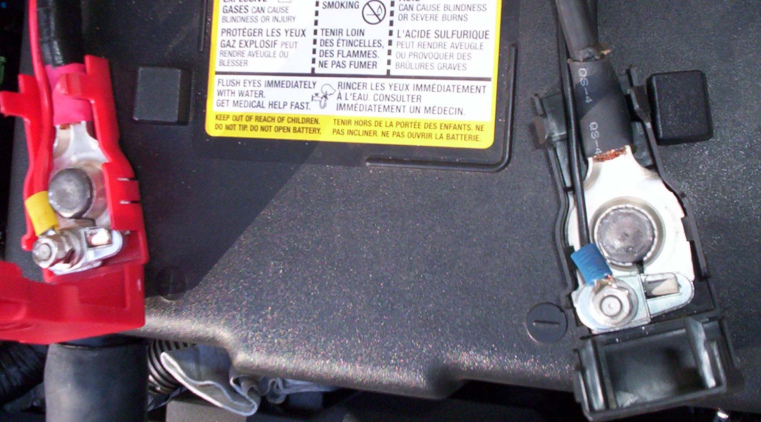

Old 11-20-2005, 04:42 PM
fourfourto's Avatar
Positive to relay and ground to compressor

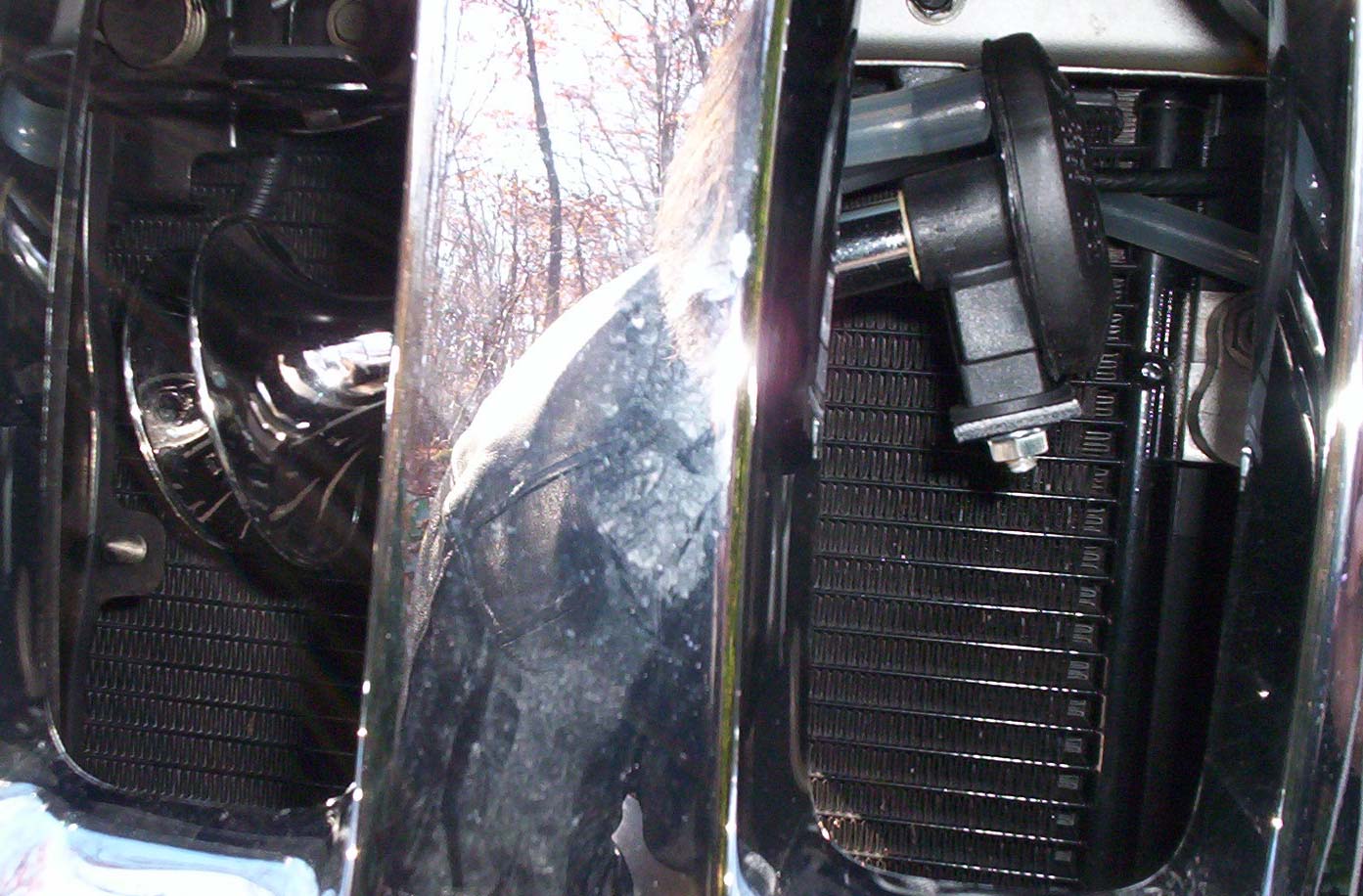

Old 11-20-2005, 04:45 PM
fourfourto's Avatar
mounted compressor to existing square hole near drivers side headlight
Old 11-20-2005, 04:46 PM
fourfourto's Avatar
shot of grill you can bearly notice them
fourfourto's Avatar
close up
Old 11-20-2005, 04:47 PM
fourfourto's Avatar
inside grill
Old 11-20-2005, 04:49 PM
fourfourto's Avatar
These were inexpensive horns 135 db
I didnt have to drill any holes used existing holes.

fourfourto's Avatar
Did anyone notice rust spots in the inside pic behind dash whats with that.
