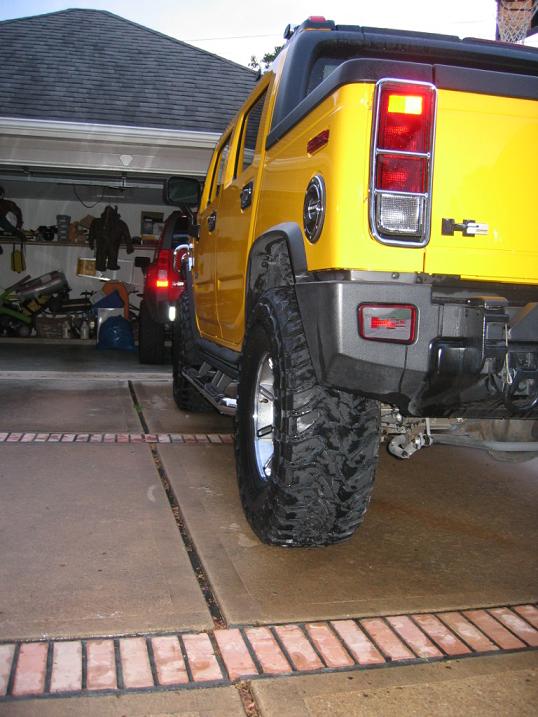

Just got my new skins put on..................

I have only had minor rubbing at the full extension of turning.............

They are slightly louder than the BFG but not bad.

I Love mine!
Congrats, looks good.

Kram looks great. I love the way those tires look on stock rims.
