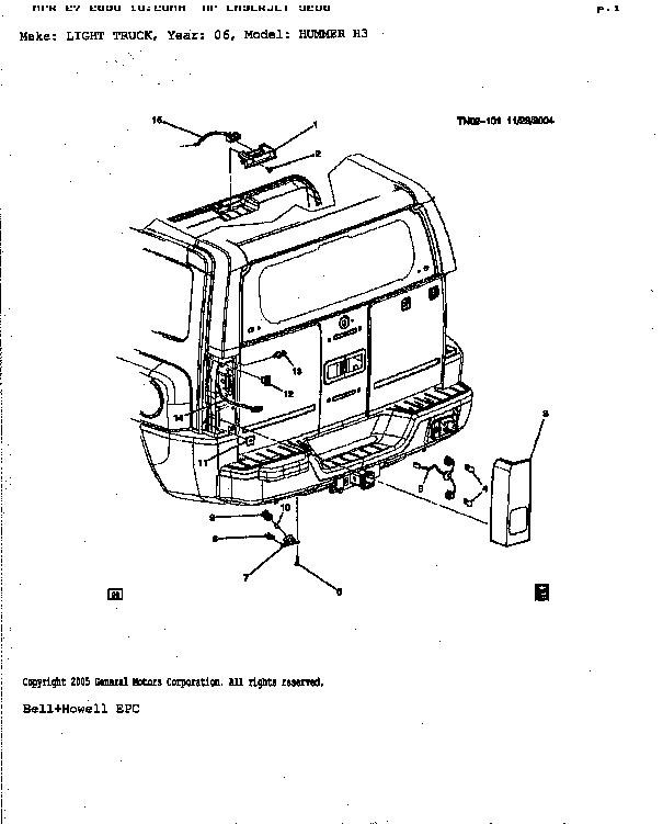

I need the clip behind the screw that holds the taillight .I broke it when installing guards.
It doesnt seem to show up on dealers diagram ? they got one in but is wrong ? They said bring your H3 in ? I said there one right there ? he removed the screw and saw the clip .He said call him tommorow.I did mention he should ask a service teck.The service guy at counter was just as confused.
I dont get it you would think it was a simple thing.
Anyway anyone have the part # of the clip there probobly cheap I would like to get 4 to have a couple extras.
I have the diagram they used but cant load it

diagram
Old 05-01-2006, 01:35 PM
fourfourto's Avatar
Diagramlink to diagram
# 13 looks like a push pin clip(if you make pic bigger) but its mounted with a screw and clip ?
Dealers still looking into it said they call me back.I will call them tommorow again.

What number did they order?Was it 11588851.
Are you also saying the push pin goes into it?
Old 05-01-2006, 02:39 PM
partsguy partsguy is offline
Posts: 1,512
Number 13 is (don't know why)called a nut,
Some kind of spring steel #11589117
Old 05-01-2006, 02:54 PM
fourfourto's Avatar
I need the clip that goes behind taillight and a screw holds it in place there are 2 on each side.
Is # 13 what I need? the clip fits into a square hole apx 1/4 inch in the body
Old 05-01-2006, 03:17 PM
Posts: 1,512
There is two plug in retainers one that goes in a round hole
at the lower outer part of the tail lamp,and the upper is rectangle plug in.
If they are not what you're after then you need the inner retainers Upper and lower are the same. (bad picture) 11589117 it should be white in color.
Old 05-01-2006, 04:20 PM
fourfourto's Avatar
Thanks partsguy I need the inner one's and there both the same so 11589117 should be them.They are white on the outside and a metal spring type retainer that snaps in. I dont know why the dealer parts guys having a problem, thanks again

Pics are working # 13 the ones they look like push pin type had the parts guy from dealer confused , not the partsguy here though.
diagram

I thinkthe part you are looking for is called a "blind nut" and is available at Home Depot, ACE Hardware or Lowes...
Do you know if they have the seal on the end.
List price is #3.51 at the dealer each .I dont know if they give you the screw even though they usually screw you .
They were not in today ,if they dont get them by tommorow I might check out home depot.
