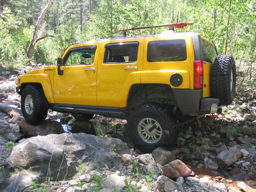

Originally Posted by GotSandH3
Anyone make or fab up some brackes for a Hi Lift jack that can be bolted
to the roof rails or maybe behind the spare tire? I just bought the fuel can mount for the spare tire. Now woundering where I can mount a Hi-Lift jack without spending thousands for a roof rack.
One of or members attached a couple of high lift mounting brackets to his roof cross bars....
