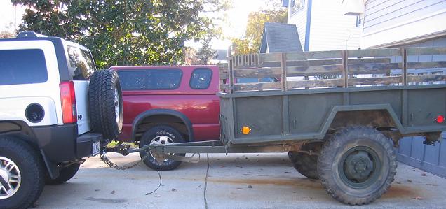

Default Re: Pintle Hooks
I'm a big pintle hook fan myself -- my trailer is the 3/4 ton version. It needs a paint job, but is otherwise in perfect working condition.
Birch White H3 Manual, Adventure Package, Sunroof, Trailering Package, Off-Road Lamps, Splashguards, Black Tubular Assist Steps, Black Crossbows, Mudder Mats, Ski Rack, Warn XD9000 w/ DOI Hawse Winch Bumper, DOI Prototype Skid Plates, M101A1 3/4 ton trailer.

Those are some great trailers!! Any idea about what they weigh?
Old 03-16-2007, 09:04 AM
bjc's Avatar
bjc bjc is offline
Location: Washington, DC
Posts: 141
bjc is off the scale
1,250lbs empty. I've made many trips to the dump where it tipped the scales at 4,000lbs, though. The H3 tows it just fine, but ideally I should have trailer brakes for the types of loads I pull.
Lex's trailer is actually a much better match for the H3. You really can't overload it to the point where it is too dangerous, and it fits and articulates nicely on the trails.
