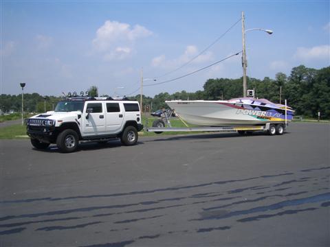

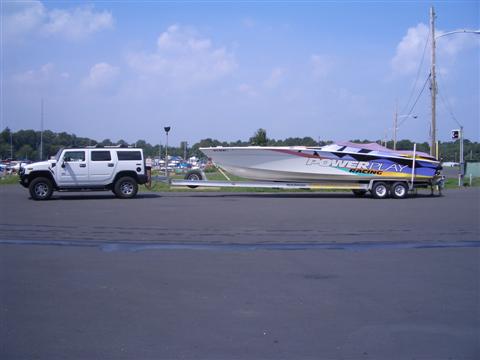

I posted a similar response to another thread regarding towing capacity. I have towed a 33' powerboat with both gas tanks full on the boat (200 gallons). I estimate the weight to have been about 8,000lbs total, and my truck did just fine. On the highway I got between 8 and 9 MPG, with the A/C on. It would definitely downshift going up any hill, and the steepest hill near my house caused it to downshift to 2nd, but that was the worst of it.
P.S. This is my friend's boat and it happens to be for sale right now (if interested, check out www.33powerplay.com).
