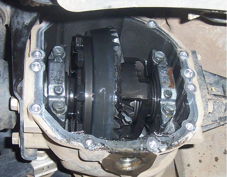

Carrier

Old 10-18-2007, 06:51 PM
SR1355's Avatar
SR1355 SR1355 is offline
Location: NA
Posts: 478
Default Re: AAM 7.25 IFS Housing Cast Iron
The pic, is that your 03H3???? Looks pretty nasty....
Paul M
SR1355

Originally posted by Sewie: We actually have the AAM 760 in the H3. And it's a 7.6" ring gear.
Originally posted by SR1355: The pic, is that your 03H3???? Looks pretty nasty....
Sewie I've read that before also. I've seen it written on spec sheets before too. The problem is, I've also seen the 7.25 written on spec sheets, and I've been told several times thats the one in the H3.
Are you positive it is the 760 with the 7.6 gear?
No Paul, I think Bebe originally posted that pic. If it wasn't hers it was in a thread she started. Thank God that isn't mine, damn thing does look nasty.
