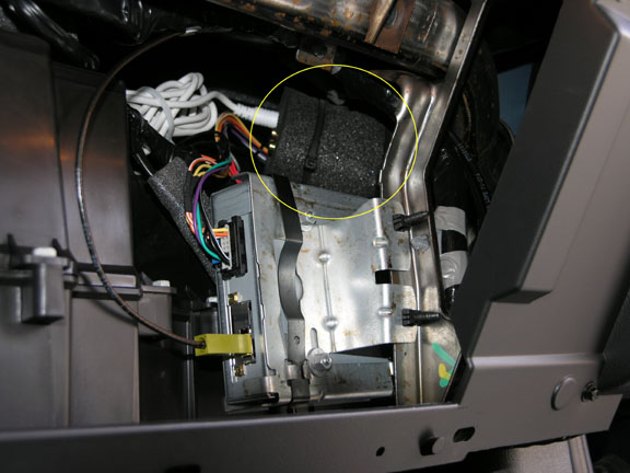

What I did was wrap the Neucleus NC-X2i in a piece of foam like this.
Name:  iPod install 3.jpg
Next plug the Neucleus NC-X2i into the harness. Route the iPod cord to were you want the iPod to be. I mounted my iPod in the left side of the glove box you may want it to be somewhere else. Now plug the iPod cord into the Neucleus NC-X2iIt will look something like this.
Name:  iPod install 7.jpg
Now tuck the Neucleus NC-X2i and its cords away like this. IMPORTANT turn on your radio but don?t touch the radio controls for a few minutes while the radio learns the Neucleus NC-X2i.
Name:  iPod install 8.jpg

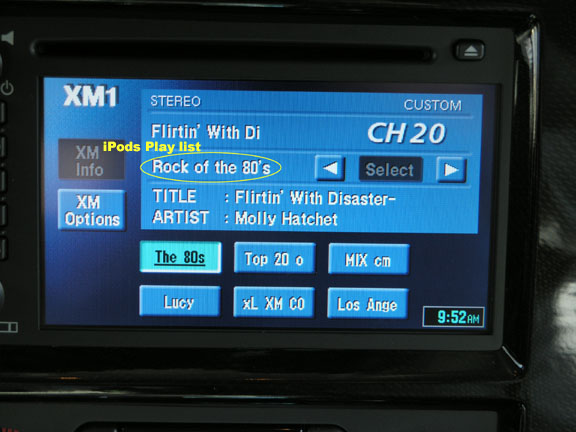

That is all that there is to it. By using the preset button #1 you can now toggle between iPod, Aux in and XM mode.
Name:  iPod install 11.jpg

How do you flip through the songs on your IPOD? Can you pick by artist or album on the Nav screen? Are you only able to pick playlists? Just curious how the controls work.
Old 02-26-2007, 06:27 PM
vlxjim's Avatar
vlxjim vlxjim is offline
Join Date: Feb 2007
Location: So.Calif.
Posts: 112
vlxjim is on a distinguished road
Default Re: Ultimate iPod adaptor and 10Min install
Can you pick by artist or album on the Nav screen?"
Yes you can pick artist or album + more using the Nav screen.
