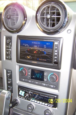

I agree, when I was researching everyone told me that they had to tuck the factory head unit into the dash somewhere. You can add a dvd to your setup and still use the bose head unit mine can be seen here.
http://elcova.com/groupee/forums?a=tpc&s=2826088551&f=6706011751&m=542107297
