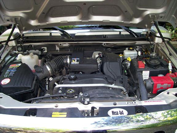

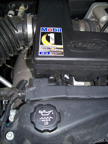

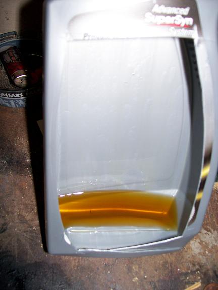

I changed my oil today and I let the container sit in the funnel 30 seconds.
I then cut the face on the container off(to dbl side tape under the hood so regular oil is never added see pic).
Look how much oil was left in there.
F5 on the ball again
Name:  m oilcan.JPG

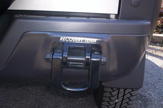

I used the H3 of a H3 recovery team sticker I got on Ebay.http://cgi.ebay.com/ebaymotors/Hummer-H2-H3-Recovery-Team-Decal-Decals-Stickers-Jeep_W0QQcmdZViewItemQQcategoryZ6755QQihZ020QQitem Z300111387706QQrdZ1QQsspagenameZWDVW
Link to install
http://www.elcovaforums.com/forums/showthread.php?t=5167&page=8&highlight=masterflow+ compressor
I used the recovery team above my rear hook.
