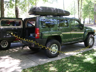

Default Easy Air Compressor Install in Rear Door!!

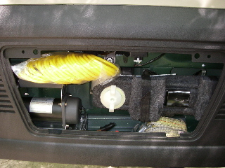

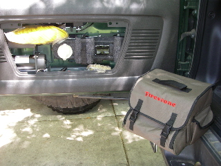

First move the jack over as I outlined here: http://www.elcovaforums.com/forums/s...ad.php?t=26221
to create a new space in the rear hatch.
Then get a Firestone Inflation Station II. ($269)
It fits right in the new space, didn't even have to remove the jack to slide it in or out!
Size:  79.9 KBName:  Imgp0707.jpg

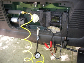

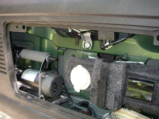

If you have a factory hitch with accesory plug adaptor you are ready to power the compressor right out of the box! Use it from inside the door or outside. You can power it from the battery directly with the clips as intended, but it's real convenient to plug into the 30A fused trailer plug (don't try to use the accesory plug inside the rear door, it won't handle the amp load). You will need a male lighter-plug that has wires that you can clamp the battery power clips to.
Size:  80.9 KBName:  Imgp0712.jpg

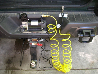

Open rear door, plug in to the trailer hitch power plug, connect air hose and you're ready.
Size:  96.8 KBName:  Imgp0714.jpg
I couldn't believe how quickly I had this thing up and running and stowed so nicely in the rear door.
Initial performance test: deflates one tire from 35 to 20 psi in 90 seconds and then inflated from 20 to 35 psi in 90 seconds.
what questions do you have?

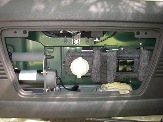

The carry bag it came in will be good for tools and recovery gear!
Shadow Green 5-Speed/GREEN GRILLE/rear door AIR compressor/Factory Nav/Lux-Off Road Pkg/Sunroof/Roof & Grille Off Road Lights/Underbody Protection/Wet Okole seat covers/Husky floor liners/Black fuel door/No Chrome/'04 Grand Cherokee Overland/'94 Isuzu Rodeo 4x4 lifted.

Nice and clean
Could you post a larger picture of the connection to the trailer plug?

my $269 included shipping from http://www.truckspring.com
here's the high tech wiring set up (only the factory external trailer plug outlet will handle 30A, don't use the interior accesory power outlet!)
Size:  81.5 KB Name:  hummer3 002.jpg

thanks for the tip, moved jack and placed compressor yesterday, took about 30 min, great idea

regarding the heat question...
There is more clearance in there than the picture shows and even more so if you get a smaller compressor.
This setup is simple and power is not connected until you stop and open the rear compartment. I haven't done a full test but I think it will depend on what compressor you have. Mine was a bit more expensive and I assume more powerful than some others, so it fills tires quick without too much strain and after doing two tires it was nowhere near hot enough to melt anything. Also the whole compressor doesn't heat up, mostly just the cylinder part with the cooling fins. With this mounting option you can run the compressor outside on the ground or from inside the door, depending on the situation.
