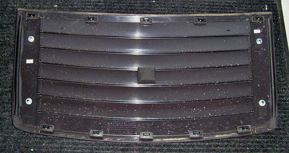

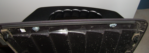

Default Re: H3 Hood Handles
These should help,
Thanks guys for all the help and pictures it has answered my questions. It really puzzled me about the headless bolts. Still not sure why they sell them like that but I guess I will just fit nuts on the ends.
