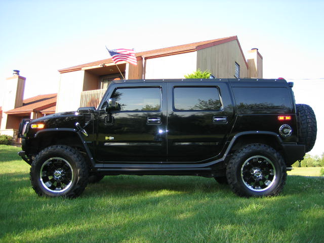

Default Re: Torsion adjusting - ?question?
37s are on - will also be adding extended shocks and steering stabilizerName:  H2 37s 004.jpg
Old 06-21-2007, 10:20 PM
IRA51's Avatar
IRA51 IRA51 is offline
Join Date: May 2007
Location: PHOENIX AZ
Posts: 681
IRA51 is on a distinguished road
Kool wheels !

Old 07-05-2007, 08:33 PM
HUM GOOD's Avatar
HUM GOOD HUM GOOD is offline
Location: New Jersey
Posts: 255
HUM GOOD has a little shameless behaviour in the past
having put on the 37s and pulled on the torsion bars to level this bitch...she's ridden rough and changed lanes whenever.....
I have since added the bilstein extended shocks up front and also a single fabtech steering stabilizer.
she is now a tamed sweetheart - doing exactly as I want her and also would say my stock ride is back -COMPLETELY - now she looks sweet and rides sweeter! .
Thanks for the help guys!
