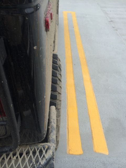

http://www.elcovaforums.com/forums/s...433#post549433
Mike
2000 HUMMER HMCS, kevlar flat black, Rubber Duck lift, Predator stage 3 kit, Predator (Wilwood) Big Brake kit, a work in progress...
2008 H2, graystone, air suspension (DELETED), U-steps, SMA brushguard w/valance (DRLs replaced by PIAA 520s), black taillight guards/locking fuel door/roof crossbars (x4), Cognito UCA/pitman-idler, Bilstein shocks, Rancho steering stabilizer, Kryptonite tie rods, green keys, Fuel D525 20" Revolver, 37" Nitto Ridge Grappler
