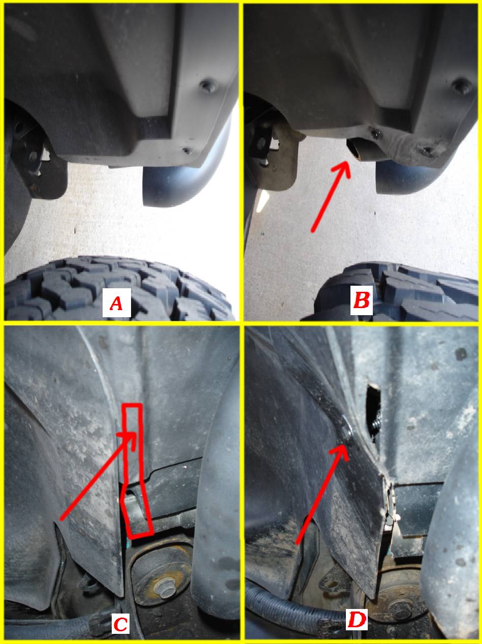

Salt Lake City Hummer -- What kind of wheels are you running on those 40's.
Its a Weld EVO Slingblade 22x9.5" Im not sure of the backspacing as of yet and i modified the wheel well by pulling back the plastic and cutting away some fiberglass and part of the rocker panel protection bar then i pulled the plastic splash guard back into the void i created with a screw. i"ll try to post some pics later, so all this crap makes sense.

MisterH2,
These are before and after pics: (B) here is a screw to suck it in tight after I cut away some material. (C) this is looking up at the bottom of the well, I cut away everything in the red (about 1/2") (D)here is that same screw pulling everything back. I also cut away some of the rocker panel protection bar, as you can see in pic #B.

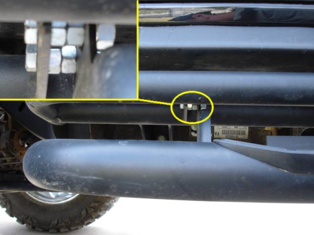

Here is a shot of my steps, I spaced them back about 1" .I just picked up some longer bolts and 48 nuts to use as spacers.
