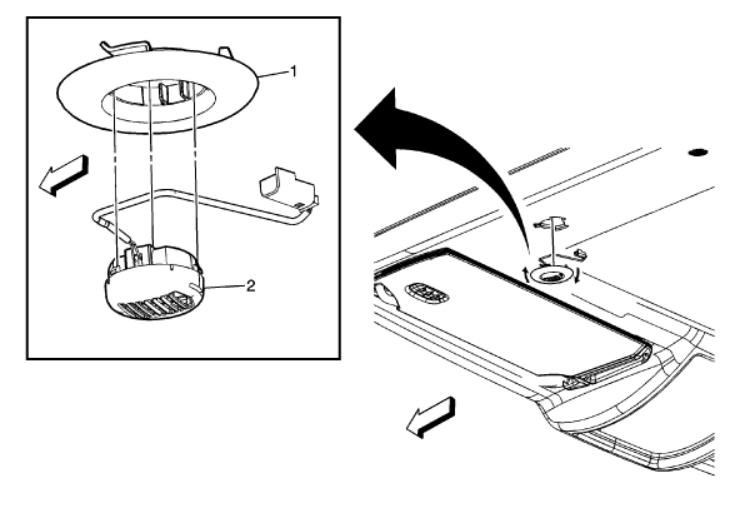

Hi this is the onstar mic. in the pic i am not sure if this is what is buzzing or the
inside air temp sensor that is back about a ft. in the drivers side headliner as HUMTECH said

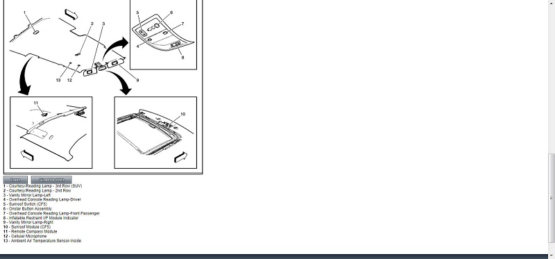

Hi 12 is the onstar mic and 13 inside air temp sensor hope these pic help.
