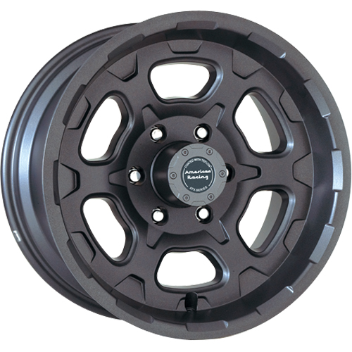

Thanks...I really like the look of your rig, it's bad ass!. I do have one question for you. What is the exact offset / backspacing of the rims you installed on you H3?

4.5" of backspace and it's not enough. Ranch said 4.5" backspace for 16, 17, or 18 rims, but plan on tearing up the inside of the sidewall of your tires when aired down. I also have 1/4" wheel spacers in the front. I am going to try 4" backspaced rims and see if that will clear. I called Rancho tech, talke d to Joe, and his comment was, this kit was designed with the factory specs in mind for wheel offest, and was not designed for airinig down that tire. He said to go with a 20" rim and I would be fine. WTF? So, I'm onto trying the different rims and if that doesn't work, the kit's going back to Rancho with a nice letter.

Damn...that sucks and I hate to hear that but at the same time I appreciate the information. Perhaps the Rough Country lift would be a better option??? I'm gonna level the front end a little (not more than 1.5") and put 35's on this weekend. http://www.truxxx.com has some good pics of an H3 leveled off with 35's. I like the look and it certainly would allow you to air down if and when necessary.
