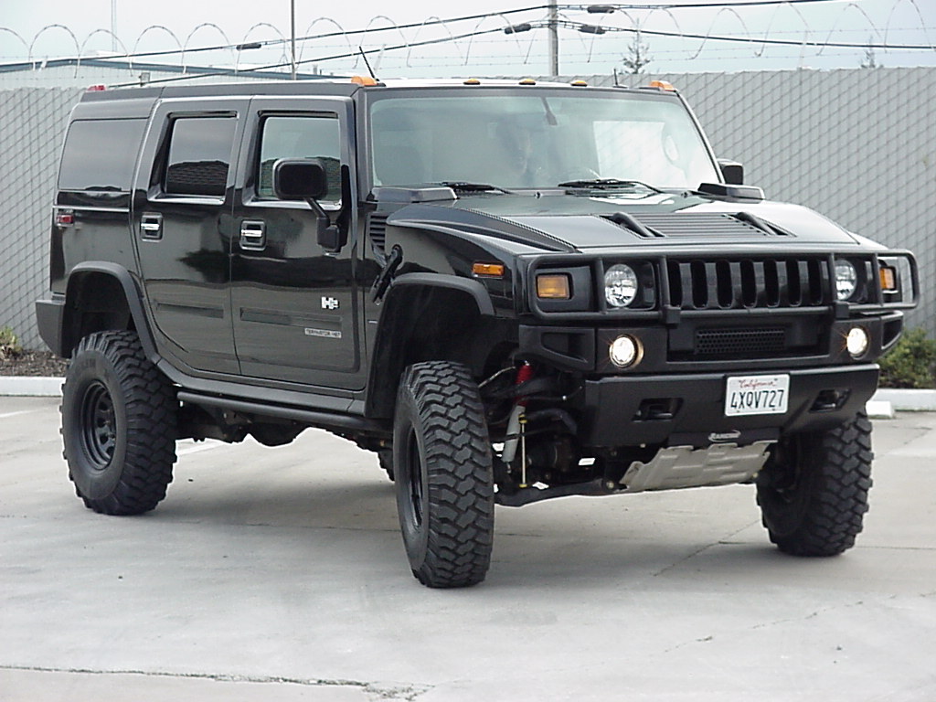

I HAD THE RANCHO 4IN LIFT PUT ON MY H2 AND I FEEL HEIGHT IS PERFECT! THE RANCHO KIT IS GREAT. I HAVE 37IN INCH MICH TIRES ON MY H2 WHICH I FEEL IS JUST RIGHT TIRE FOR THE LIFT. MY H2 DOESN'T FEEL TOP HEAVY AND HANDLES GREAT OFFROAD.

Wow, that looks great!!! I really dig the all blacked out look. Looks like some sort of Special Forces vehicle.
How do you like those tires? I've never seen them before.
Looks like you might have room for a set of 38" Swampers. Did you consider going with a tire like that?

That is a great pic! How'd you do the grille?

I HAD SENT MY H2 TO LOCAL BODY SHOP AND HAD THEM BLACK OUT ALL THE CHROME EXCEPT FOR DOOR HANDLES BECAUSE THEY FELT THE PAINT WOULDN'T HOLD UP ON DOOR HANDLES BECAUSE OF ALL THE USE.
IT WAS NO BIG DEAL THE BODY SHOP HAD MY H2 FOR ONE DAY AND IT TURNED OUT GREAT. THE 37IN MICHELLIN TIRES I HAVE ARE MADE IN EUROPE FOR THE MERCEDES UNIMOG. I CHOSE THEM BECAUSE THEY ARE ONLY AROUND 10IN WIDE, AND THEY ARE ELOAD RATED, 8/PLY, STEEL BELTED RADIALS. I HAVEN'T TRIED 38IN SWAMPERS BUT I CAN TELL YOU THEY WOULD EASILY FIT. THANKS FOR YOUR COMMENTS.

Would you happen to know the overall height front and rear since your Rancho 4in lift and 37's?
Thinking of doing it but not sure if it will then be garged or outside in my driveway.
Hopefully will go into my 81.5 inch garage without the rails.

WITH THE 4IN LIFT AND 37IN TIRES YOU WON'T BE ABLE TO FIT CAR INTO YOUR 81IN GARAGE. RIGHT NOW THE HEIGHT IN FRONT IS APROX 83IN AND MY BACK IS AROUND 84IN (WITH RACKS OFF).

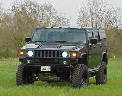

HERE A SOME MORE PICTURES OF MY RANCHO 4IN LIFT.
SORRY THESE WERE ONLY ONES I HAVE.

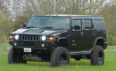

ANOTHER PICTURES OF 4IN LIFT

Thank you for the added picture - mighty fine!

That thing is totally BADASS, I love that blacked out look. I really like the look of those tires too.

The all black look is very cool. Very nice looking rig.

wheels-size//offset//where purchased? truck looks great I'm getting my grill to body shop tomorrow your pics convinced me!
