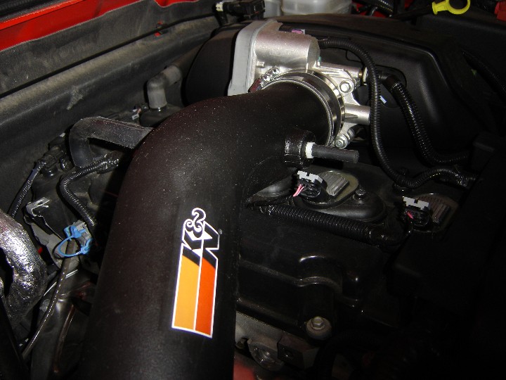

I purchased my K&N on ebay for $216.00. Install was no problem. Took it out for a spin after I did the install and all went fine. No rattling, no abnormal engine noise. I hope to see a slight improvent on performance and gas milage.
I am looking into Magnaflows or Borlas for a cat-back exhaust in the near future.

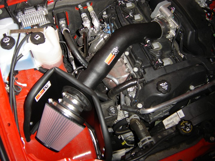

another pic.

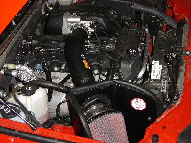

and heres another.

Looks like a clean fitment. Let us know how it goes

why does the tube's diameter decrease at the filter.
according to the commericals, is that really a precision engineered tube or bottle neck restriction to increase velocity or some bs?

"Next we attach the filter to a rotationally molded tube made from interlaced High Density Polyethylene. This process allows us to precisely shape the tube to reduce turbulence and accelerate airflow into the engine. This is why some of our tubes have unique shapes or indentations that are specifically engineered for each application."

This is where the mass air sensor is transplanted from the stock air box base to this area. The internal cross sectional areas have to be the same for proper air flow rate measurements.

Nice Install Fly looks so sweet that mine will be here Thursday.
