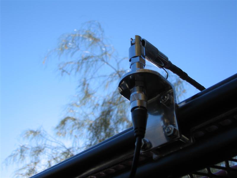

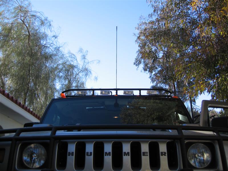

Antenna ...
\'05 SUT
  #73
Old 01-16-2006, 08:46 PM
rodster rodster is offline
Posts: 1,571
rodster is off the scale
Base ...
\'05 SUT

Antenna folded. Still have to decide what to do with the matching wire. Directions say it's only necessary if SWR won't go sub 2.1. Suggestions?

Considering that it is mounted on the rack and the best match you can get with a solid roof mount is 1 to 1, I would leave it alone and be greatful. Great job and it looks great to.

Antenna folded. Still have to decide what to do with the matching wire. Directions say it's only necessary if SWR won't go sub 2.1. Suggestions? </div></BLOCKQUOTE>
You don't need it.

You shoud finish by sealing all the connections with clear Plasti Dip including the clamps on the rack. That will keep the contacts dry and tight. The hinge join don't use the Plasti Dip, use dialectric grease and re grease it periodicaly.

Thanks again, Dick. I'll snip the matching wire, leave the tuning alone and seal the connections. I have a good supply of PlastiDip -- it's a favorite tool, so to speak.
